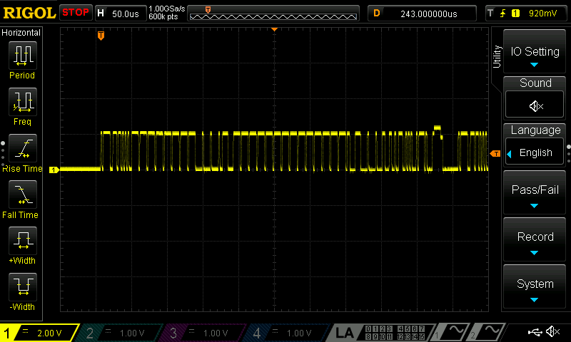

Her the scope when everything goes well:
pData = [0xFF, 0xFF,0xFF,0xFF,0xFF,0xFF,0xFF,0xFF,0xFF,0xFF,0xFF,0xFF,0xFF,0xFF,0xFF,0xFF,0xFF,0xFF,0xFF,]

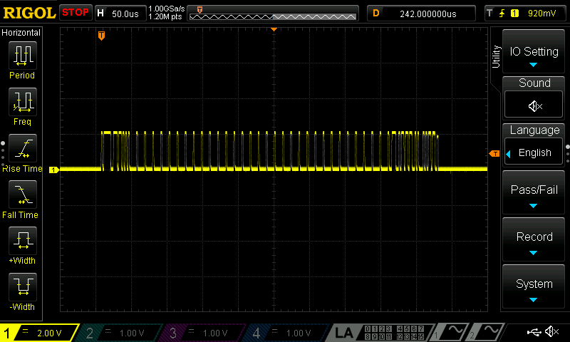

0693W00000BaoGAQAZ.pngNow when the error occurs.
pData = [0x00, 0x00, 0x00, 0x00, 0x00, 0x00, 0xFF, 0xFF, 0x00,0x00,0x00,0x00,0x00,0x00,0x00,0x00, 0x00, 0xF0, 0xFF, 0xFF]0693W00000BaoGFQAZ.pngThe data length has not changed, its just the payload which has changed.
