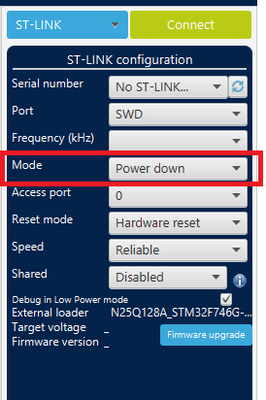

mƎALLEm
First, ST-Link utility is obsolete so please use STM32CubeProgrammer downloadable from this link.
Second, with STM32CubeProgrammer tool, try to connect under "Power down" mode:
STea
Hello @mallesh_makershive ,
You try to connect the board via CubeProgrammer  and check for static security and option bytes you maybe have changed something related to RDP levels or flash protections and it can be the cause preventing you from connecting in debug mode as explained in this document
