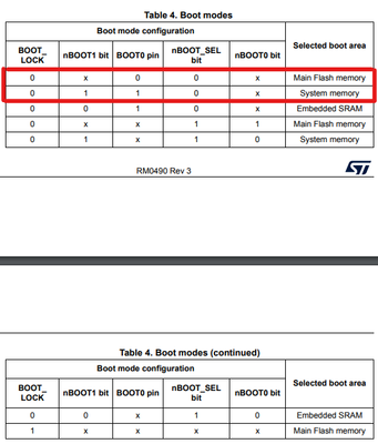

If you want to use the System Bootloader, then first check this table
You can find it at STM32C011 Reference Manual (https://www.st.com/resource/en/reference_manual/rm0490-stm32c0x1-advanced-armbased-32bit-mcus-stmicroelectronics.pdf)

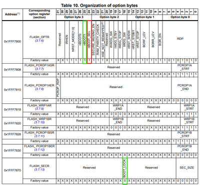

So what it's saying here is that if you want to boot with Flash Memory, you must first guarantee that the configuration bits are as follow:
BOOT_LOCK = 0
nBOOT1 = 1
nBOOTSEL = 0
nBOOT0 = don't care, can be either 0 or 1
Then you can select which one (System or Main Flash) by toggling BOOT0 pin. But the default factory value for nBOOTSEL is not 0, it is 1. As for the other bits, they're fine at factory values.
A good thing is that when the Main Flash is empty, the device defaults to booting from System Memory, but you must be aware that the first thing you must do is to clear the nBOOTSEL bit to 0, because if you don't do it and flash you application firmware to STM32C011, you won't be able to reflash/update it without using a programmer connected to SWDIO/SWCLK pins.
