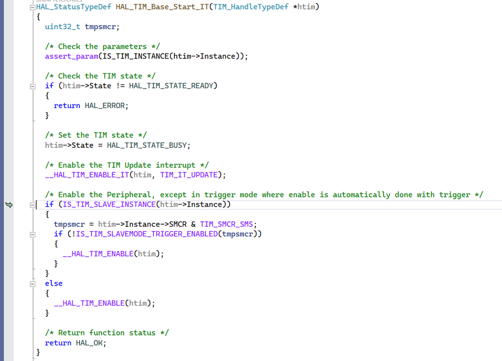

I have a problem with interrupts on my STM32G474VEH6 based board. Timer 6 generates an interrupt every 1ms.
Program crash at HAL_TIM_Base_Start_IT(&htim6);
But after resetting the power of the board, the software starts working correctly.
The same code works fine on Nucleo-g474re.
Generate code with STM32CubeMX 6.6.1
IDE: Visual Studio 2022 with VisualGDB 5.6R8 build 4723.
Tested on STM32CubeIDE 1.10.1 same result.
Thanks in advance for your help

The program enters a function and gets stuck inside without exiting.
Nothing happens. Еverything is stuck.
The system is not reset.
When I do a step by step in the HAL_TIM_Base_Start_IT() everything goes through but the interrupt doesn't fire.

When I stop the MCU it stops at "IS_TIM_SLAVE_INSTANCE(htim->Instance)".
0693W00000WLOgBQAX.pngOne more point: if I try to "reset the device" (not reload), the system won't enter for debugging, it looks like the MCU won't start after the reset. The same happens if I check "Reset device after programming"
