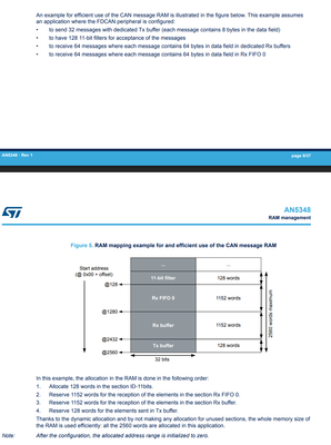

At the moment I am busy sending CAN messages.
According to AN5348, the FDCAN has dedicated Tx buffers and optionally
a Tx FIFO or a Tx queue (Figure 4. CAN message RAM mapping.)
The FDCAN controller on the STM32G474 seems to be like a
minimal implementation of the controller described in the AN5348 -
obviously 32 Tx buffers are possible, but the STM32G474 has according to.
Reference Manuel only 3 of them. And as I understand I understand, they are
used as a TxFIFO or a TX queue - therefore there are no "dedicated" Tx buffer !?
Or can I simply use the 3 buffers in a detected manner by ignoring
the TXFQS registers and working only with registers TXBRP, TXBAR and TXBTO?
I am also not quite clear what the distinction Tx buffer
and Tx queue is all about (AN5348 / p.23): Figure 19. Mixed
configuration with dedicated Tx buffers and Tx queue)?
Actually I would like to use a buffer for cyclic
sending messages with high priority, a second buffer
should be feeded permanently from a software FIFO by means of an
interrupt, while the third shuold be keept free for later expansions -
I am not sure now, whether that can be implemented with the
FDCAN controller of the STM32G474?

I am also struggling with the STM32G4 fdcan library, did you figure out if Rx and Tx use the same buffer? Have you managed to increase the Rx or Tx buffer size from 3?
Thanks for the info you have provided so far
Hello Anon
As I recall, on the STM32G4 the TX Buffers are fixed to 3 (hardware). It cannot be changed
hello Johannes
In STM32G4 Datasheet, "A 3-Kbyte message RAM memory implements filters, receive FIFOs, receive buffers,
transmit event FIFOs, transmit buffers. This message RAM is shared between the three
FDCAN modules"  But I can't find about "TX Buffers are fixed to 3"
I want to change the TX buffer, Please tell me Where does "TX Buffers are fixed to 3" come from?
Many thanks, Bro
They share the same RAM.
You can check this graph in AN5348
