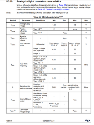

Hello @lliwdliw
You are using ADC outside the max frequency recommendations.
As you can see in DS12288 Table 66 below:
fADC Max = 60MHz.
BR
Romain,
ADC clock 160/4 = 40 MHz is OK
At 40 MHz 2.5 clock are 0.0625µs. For a step of 3.3V from one channel to the next this is a slew rate of 53V/µs.
To charge a capacitor of 5pf.
Are you sure your buffer has such a slew rate? Check the internal output resistance of the buffer...
