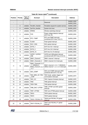

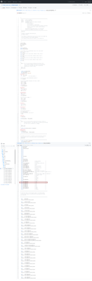

> I am looking for the interrupt function related to the duty setting registry
Where do you look for it?
It's screenshot of the startup code, clicking on it it will bring you to the highlighted line, which is the item in vector table - you are supposed to write an ISR with that name.

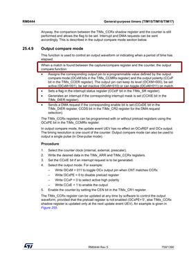

You can find more information on this in RM0454 if needed.

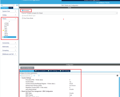

Trying to explain it though:
In CubeMx it looks like this:
You choose your timer in question on the left and you activate it.
In the NVIC Settings tab, the global interrupt should be activated:
This checkbox will create your callback in the stm32g0xx_it.c file.
