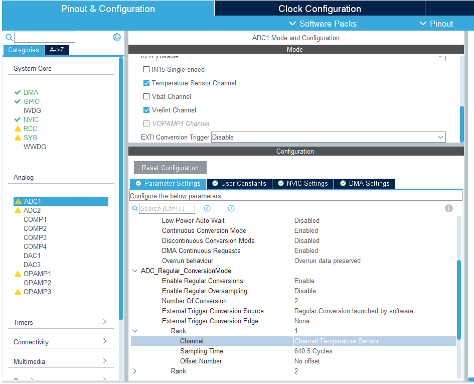

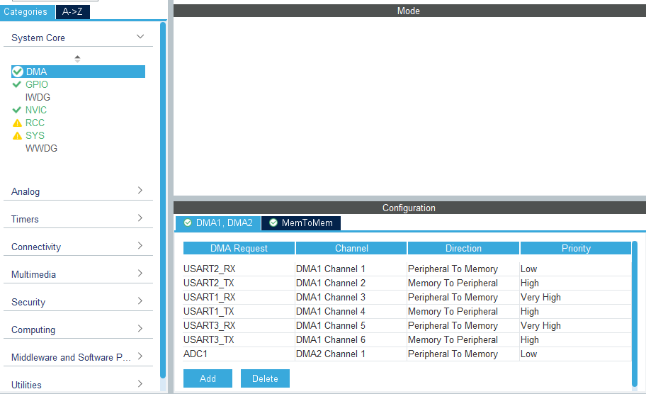

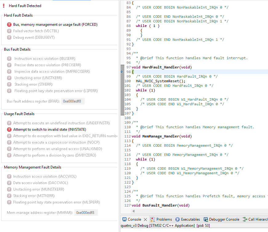

I'm using ADC with DMA in a large project, and faced some very strange problem:
If I'm using DMA2 Channel 6 - ADC works correctly
If I'm using DMA2 Channel 1 - the SW end up in Hard Fault
Screenshot 2025-10-07 125752.pngScreenshot 2025-10-07 125821.pngScreenshot 2025-10-07 124405.png
The configuration is default.
This is how I start the conversation
  HAL_ADCEx_Calibration_Start(&hadc1, ADC_SINGLE_ENDED);
  // Start the ADC in DMA mode
  HAL_ADC_Start_DMA(&hadc1, (uint32_t*) g_ADC_values, ADC_BUFFER_LENGTH);

What is the stack trace when the hard fault happens? What code is causing it to hard fault?
The random code, it depends when ADC triggers the DMA
I can't make sense of this answer.
Using DMA doesn't cause a hard fault in itself. It's possible the DMA is misconfigured, or trying to write somewhere it cannot. Look for the reason it's hard faulting and go from there.
Try start with show where and how is declared
g_ADC_values
and maybe after calib start is good practice wait for some end...

Long story short, I can't avoid this problem but I'm almost shure it was coz of RAM tension I've got in my firmware. I lose my patience and just switch to STM32G491 - now it works like a charm :)
