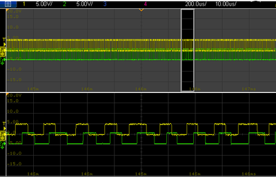

Observe the waveforms on oscilloscope.
Is the duty cycle of both waveforms close to 50% and the phase shift between them close to 90deg. at the high rotation speeds, too?
The oscilloscope waveform looks like this. Currently, speed control is not working properly, so the duty cycle is not at 50%.
Danu
This looks OK.
And this is the speed where it starts to lose pulses?
When I spin the motor as fast as I can by hand, the count should be 0 when it reaches the home position, but it ends up around 3200, so counts are missing. The motor is currently running with the code generated from MC Workbench, so I cannot determine at which speed the counts are missing because the encoder counter is abnormal, and RPM control is impossible. When I checked the encoder signal with an oscilloscope, the signal was about 100kHz, which corresponds to around 5000 RPM. At 5000 RPM, the counter doesn’t increase at all.

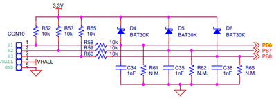

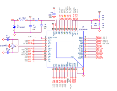

I am using the EVLSPIN32G4-ACT board. When measuring the encoder waveform from the GPIO port, I noticed signal distortion.
After checking the circuit diagram of the EVLSPIN32G4-ACT board, I found a 10kΩ + 1nF RC filter on the encoder pins. After removing the 1nF capacitor and reading the counter value, it worked perfectly without any missing counts!
