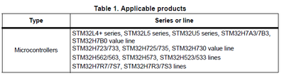

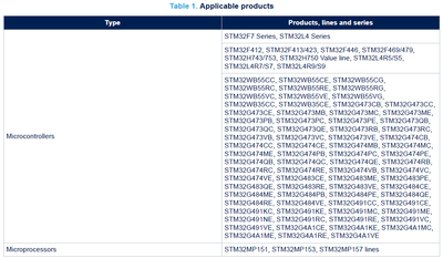

I prefer to provide you some application notes on which there is a table showing the devices featuring peripherals you are needing then you can decide youself according your needs:
DSI: see details in this AN4860 Introduction to DSI host on STM32 MCUs and MPUs:
QSPI: see details in this AN4760 Quad-SPI interface on STM32 microcontrollers and microprocessors
OCTOSPI: see details in this AN5050 Getting started with Octo-SPI, Hexadeca-SPI, and XSPI interfaces on STM32 MCUs

‎2024-09-10 4:08 PM
Thank you @mÆŽALLEm
useful links but after going through them, I did not see anything in there about GIF/animation and transparency or layers. Specifically how to choose some micros that allow or support those features.
Could not find any app notes either but I might heve been googling the wrong terminology. Any app note or suggestions/guidelines about those two topics and how to select micros that support them?
Thank you
‎2024-09-10 4:13 PM - edited ‎2024-09-11 1:21 AM
Image animation and transparency are managed at TouchGFX library level not by hardware.
Hope I answered your questions.
