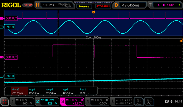

Few days ago i've encountered a strange behavior of the comparator at STM32G4. I investigated the problem under controlled conditions (used Nuclo kit instead application PCB) and the result is startling.
Comparator 4 configured to get positive input from pin PB0, negative from DAC1 Channel 1 (set to 500mV).
Hysteresis set to maximum (70mV)
DAC output is not connected to external pin (only internal connection)
Input signal is 50Hz sinewave with 400mV amplitude and 600mV offset (to reliably cross 500mV thresholds +- hysteresis)
Enabled Comparator 4 rising edge interrupt.
Interrupt routine simply generates fixed length pulse.

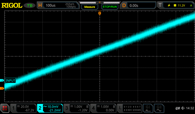

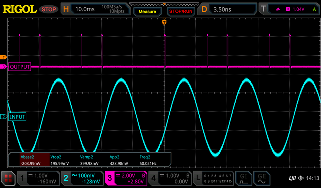

On blue scope trace you can see clean input signal (scope input AC coupled), it certainly does not contain noise that would be close to hysteresis value (more detail at last screen).

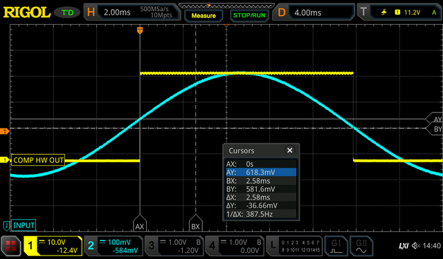

On Red trace is application output. You can see that many times interrupt fires also on falling edge, or fires multiple times on tha same rising edge. It looks like that comparator works withou hysteresis. But if you take a look on next screenshot, you will se comparator HW output (yellow) witch marked thresholds. They are separated by about 40mV which corresponds to "typical" value of "70mV" hysteresis. And of course, comparator registers are correctly set to hysteresis level "7".
On yellow trace is comparator HW output (PB6)
Last screenshot shows that there is not excesive noise to "false" trigger comparator.
False falling edge detectionFalse falling edge detectionDouble rising edge detectionDouble rising edge detectionHysteresis provedHysteresis provedSmall noiseSmall noise

It is not an input noise problem. Following simple observation prove that:
I can set positive going threshold to 1.100V, negative threshold 1.05V (hysteresis 50mV) and then i can move DC signal very slowly from 1.000V upwards. When i reach few mV close to 1.100V then comparator single (!) flips. Sometimes with "artefact" sometimes without. And then its output doesn't change anymore. When i slowly decrease input voltage, output is still unchanged. Only when input voltage reach very close (few mV) to 1.05V then comparator single (!) flips back (again with or without "artefact"). If there is any excessive noise able to flip comparator output back and forth, then it must be observed most of the time when the signal is in range between positive and negative going thresholds. And i do not observe anything like that (can be also readed out at third screenshot in my original post).
I'm not an "arduino newbie" who tries to blame it on a chip bug whenever something fails. Problem is that the comparator single (!) flip is sometimes defected. Its overall behaviour is absolutely normal, hysteresis works and reliably suppress all "macroscopic" false flips caused by ordinary noise (<10mV). But in time of single flipping, there is high probable very specific "artefact", which have  unpleasantly consequences with asynchrounous EXTI.
