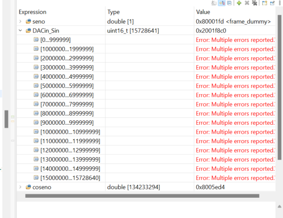

What I did in my code is creating a buffer (to be transferred with SPI) of uint16t with the math.h header and the sin function. Maybe this is not suitable for a microcontroller...
I do not receive any error after building, but I see this message in the window in the right side after clicking debug

		double seno[n];
		double coseno[n];
		uint16_t DACin_Sin[n];
		uint16_t DACin_Cos[n];
		uint16_t i=0;
		  while (i<n)
			seno[i]= sin(i*2*3.1416/n+theta*3.14/180)+1;
		  	coseno[i]= cos(i*2*3.1416/n)+1;
			DACin_Sin[i]= seno[i]*(pow (2,N))/(2*k);
			DACin_Cos[i]=coseno[i]*(pow (2,N))/(2*k);
		 	i++;

> Honestly this is out from my little understanding of microcontroller
This is more a general C/programming issue than specifically microcontroller-related.
For DMA buffers, use arrays defined as global variables, i.e. outside any function (usually at the beginning of given source .c file).
As it is defined now it will work, as main() is the higher-most function and will never exited, but it's a not good practice for various reasons I am not going to detail at the moment.
