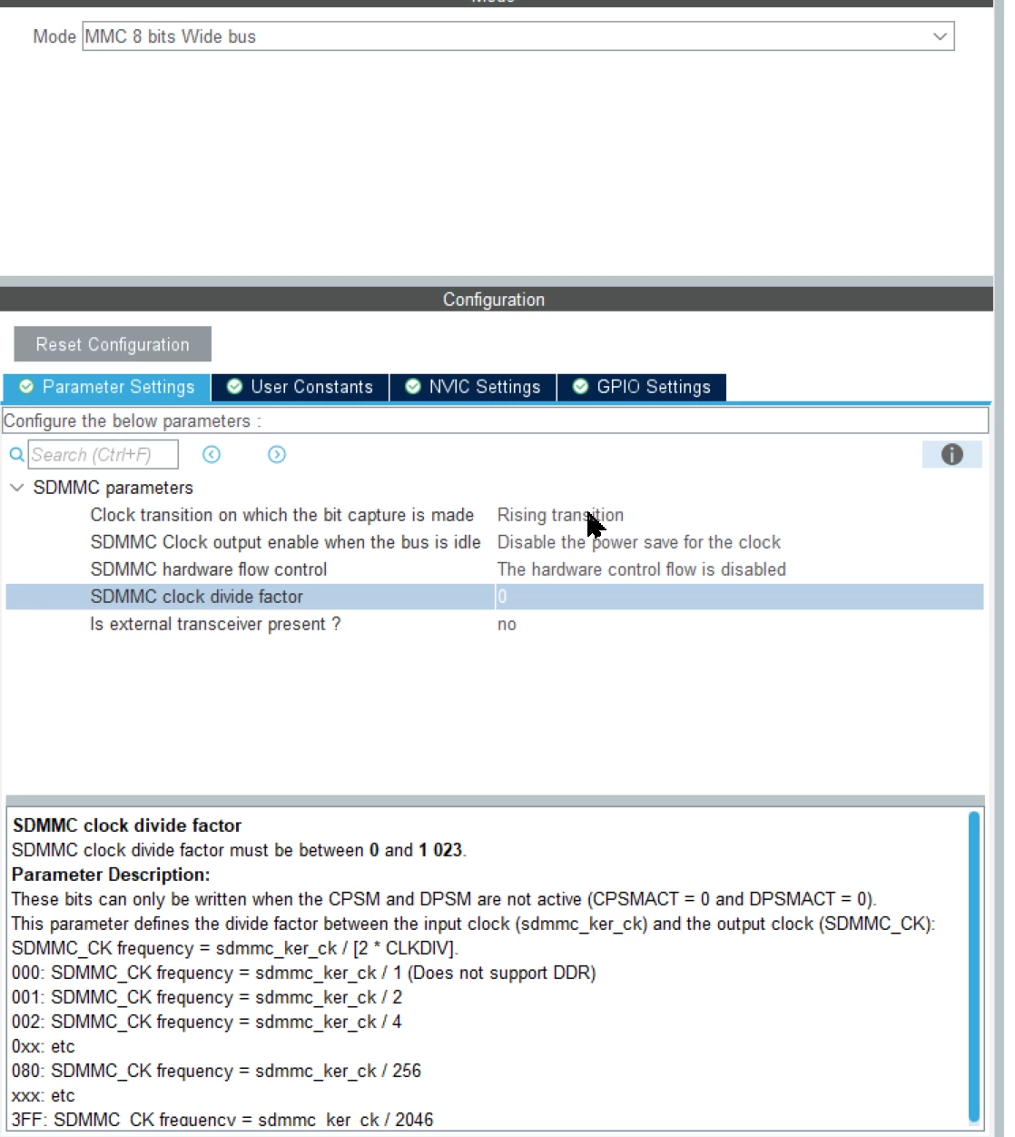

Has anyone used the STM32H750B-DK on-board eMMC, 4GB memory.
I have been unable to find an example and it is a big job to write something from scratch.
I am assuming that it would use the SDMMC1 peripheral in MMC 8 Bit mode and that you would need to port fatFs to it.
I cannot find any detailed data sheet on the THGBMTG5D1LBAIL / THGBMDG5D1LBAIL chips to get the correct timing data etc.  Does anyone know where to get a detailed sheet. All that is readily available is a data brief for promotional purposes.
The parameter settings for the interface are pretty basic:
So it shouldn't be too difficult, but any help would be appreciated.

Doesn't the eMMC spec drive the timing expectations? Or impart via the EXTCSD
52 MHz should be sustainable, in a 1,4 or 8-bit SDR sense
Perhaps look at
STM32Cube_FW_H7_V1.9.1\Projects\STM32H745I-DISCO\Applications\FatFs\FatFs_Shared_Device
STM32Cube_FW_H7_V1.9.1\Drivers\BSP\STM32H750B-DK\stm32h750b_discovery_mmc.c
Been an age since I poked at this one.
Might be a bsp, display or demo one for the H750B
