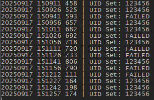

For some reason the PGSERR and PGAERR flags are always set when the board is programmed or this function is entered, which is why I am manually clearing them to prevent failure at the HAL_FLASHEx_Erase function.
The issue that I am having relates to the CFGBSY flag, which is sometimes set on boot or after a successful write (but not always), and I cannot clear the flag as it is set/cleared by hardware. For some reason the CFGBSY flag will eventually go low after successive calls to the Flash_Write function even though the function returns if the flag is set.
If anyone has any ideas on why my flags are acting up I would greatly appreciate it.
Issue #1. This can be caused if something writes only half of a flash page.
If CFGBSY is high, there's a pending erase or write operation. Is PG high? Probably a pending write operation. Solution is to wait for CFGBSY to drop.
Could be an issue with how your board is getting programmed prior to debugging. Maybe debugger is only writing half of a page. Ensure the HEX/ELF/BIN file (whichever is used to flash) is a multiple of 8 bytes.
