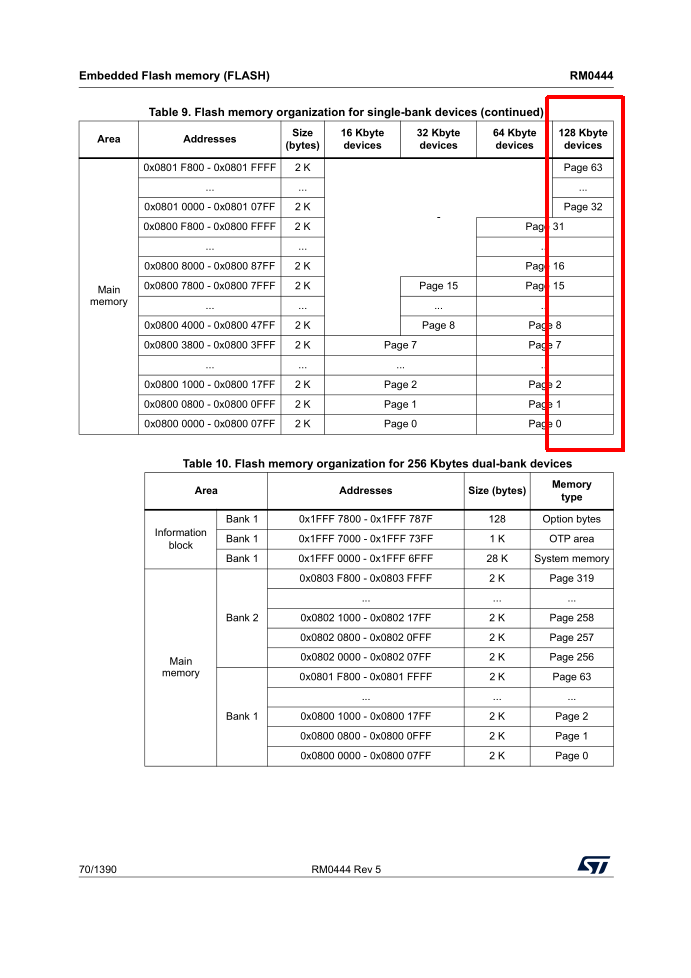

Hi good day, could you guys please tell me where i can get the STM32G0B1KBT6 flash module organization Table? i've looked for it on datasheet but found nothing
You can see the document number at the top and bottom of that screenshot. Also look at there:
https://www.st.com/en/microcontrollers-microprocessors/stm32g0b1kb.html#documentation

where did you get it? i've tried look for it on the whole datasheet but didnt found it
thanks a lot sir, i've found it on the reference manual inside the document instead of clicking download datasheet.
