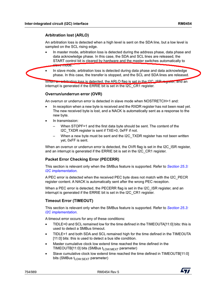

In practice, it doesn't work at all. I'm actually trying with 2 target devices and the controller on the bus, but observing the SCK and SDA lines for both target shows that the overall payload seen on the bus is the payload of the first target transmitting data different than 0xFF. There's actually no "merging" of the payloads.
I've checked that it's not a HW problem (mux or PCB) because I modified the code such that the target STM32 device that I expect to not be able to communicate breaks the SDA line by driving the line low in the middle of the data payload transfer. And I did observe the expected communication breaking on the oscilloscope.
I'm kinda at loss here.
My best guess is that STM32 I2C HW implements some kind of error checking, monitoring what it sends and what is seen on the bus and then aborts the I2C transfer when the two don't match.
Does anyone have any insight on this ? I know this usage case isn't specified by the I2C specification, but there's nothing saying it shouldn't or doesn't work.

So I've been digging on this problem and here's what's new :
Communication from the DMA point of view is incomplete. I have 32 bytes to transmits, but for the target device that failed transmission the DMA CNTDR (counter register) value is 22, meaning it has managed to transmit 10 bytes to the I2C peripheral and the I2C has sent at least 9 of these bytes before stopping transmission. This 10 bytes value is not random, it's precisely the index of the first byte sent on the bus that is not 0xFF for the other target transmitter, so it strengthens the hypothesis made earlier.
I've tried to understand better why it stops the communication so I've looked into I2C ISR before and after a transmission failure.
Before the failure the arbitration lost flag is clear but this same flag is raised after the transmission. I suspect that it's this flag being raised that stops the communication in I2C HW block.
What I fail to understand is why is this flag relevant here, given that arbitration should occur only in a multi-master bus configuration.

This is how the I2C module in 'G0 works:
While arbitration is a matter of masters indeed, using multiple slaves answering to the same address on the same bus is I2C protocol violation too.
‎2022-06-15 2:04 AM
Oh okay, I feel kinda embarrassed for not having noticed this valuable piece of information earlier.
Thanks a lot !
