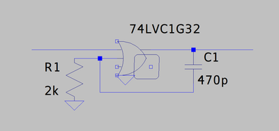

AScha.3
just put a simple gate at the pin, making any positive pulse longer (1 us or so):
...and problem solved.
