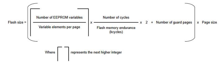

Formula
Application note an4894 gives a formula to calculate the required size of flash memory, but I want to make sure I am using it properly. Also note, I am using a STM32G070CB, which has a flash memory endurance of 1K cycles. This is less than the standard 10K of most other STM32 MCUs.
Here is the formula:
Here is my calculation, I would appreciate if anyone can confirm I am doing it correctly!
I want to store a max of 50, 32 bit variables.

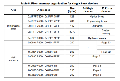

The page size of the STM32G0 series is 2KB.
The flash memory endurance is 1K cycles.
Variable elements per page = 500 = 2000 byte page size / 4 bytes for each variable
Number of EEPROM variables = 50
Number of cycles = 10000 (more on this later)
Flash memory endurance = 1000
Number of guard pages = 0
Page size = 2000 (2KB page size)
I get a result of 40KB from the formula.
That seems very high to store 200 bytes of data, so I don't know if i'm doing somthing wrong.
If I am doing things correct, I guess it is so high becuase I am trying to get 10K cycle endurance with 1K cycle endurance flash.
If I modify my requirements to only be 1K cycles, I get a result of 4KB.
Are you sure that's not 2048 ?
I was a bit confused by that actually, but I think you are right.
The reference manual says 2K, but the number of addresses per page is 2048.
