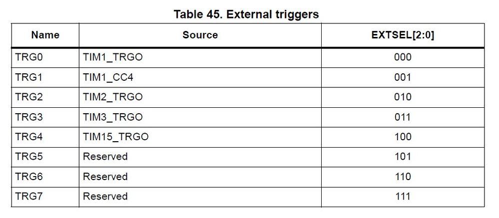

‎2019-02-05 12:17 AM
I'm using STM32F051 - this is the ADC trigger
Can use TIMx_CH1 for timer clock and also for input capture?
‎2019-02-05 12:19 AM
Nice work-around, I'll consider it
