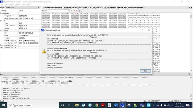

I'm using STM32F767 custom target board with J Link debugger, everything was working fine since last 2 months till today morning, while debugging my existing project following pop up message came up. instead of selecting options right way, I've checked for similar issues reported earlier and found some posts where selecting yes was good option. I've selected yes and then I was not able to debug target , directly its going to hard fault handler. I see flash programming steps are ok. then I've tried J link commander to erase(EnableEraseAllFlashBanks) flash but therein it returns error -5.
Please help me to resolve this issue

I've tried erasing STM32F767VG through JFlash tool, but there I get error,below is the log from JFlash tool, sometimes it gives RAM read error(picture is attached)
did anybody faced similar issue, any clue to resolve it?

AShel.1
Tried erasing sectors from 0x08000000 but it gives error, is it because of flash is corrupted?

Please don't PM on threads.
I don't have any specific experience with the Segger Debugger
You'd probably want to ponder what changed in your code or system between the time it worked and stopped working.
Software updates/installs.
Changes to code related to flash, pins, debug settings, etc.
If you had additional boards you could at least make a determination if it is a chip level issue, or a more systemic one.
See if it follows onto a second computer, using different ports, cables, etc.
