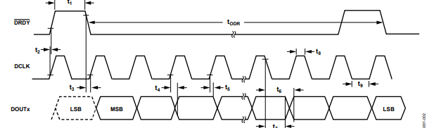

This is the timing diagram of the ADC that is sending the data to the MCU (AD7768-4)0693W000003PjzlQAC.png

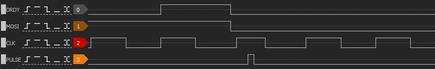

Well here you go. I expect that you now have a solution for my problem.
The PULSE signal is there so that I can visualise when the SPI has been enabled (using SSI) and when the DMA transfer has been completed. The first pulse is sent after the SPI has been enabled so that I don't introduce additional delay.0693W000003PnW3QAK.jpg

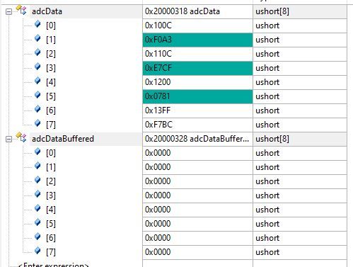

And here are the values:
0693W000003PnXQQA0.jpgThe second buffer is empty as I didn't sent a measure command yet. Indices 0, 2, 4, 6 are the ones holding header data that is constant. And only the 8 MSB are the header data. Everything else is the ADC measurement data. So if I would combine [0] and [1] that would give me 0x100CF0A3 and 0x10 is the header indicating channel (0) and some other status bits and the 0x0C40A3 is the 24 bit measurement data. Same goes for 2,3 and 4,5 and 6,7 (this is a 4 channel ADC).

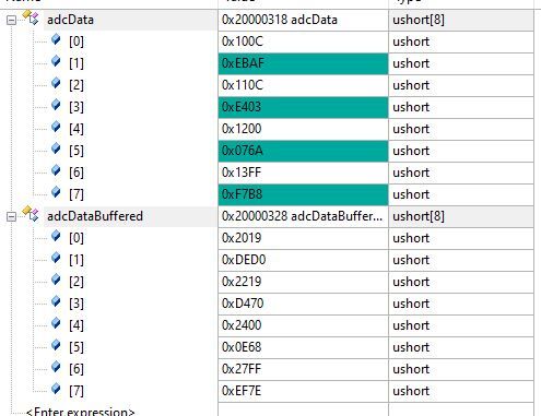

Once I send the measure command over USB this is the result:0693W000003PnZWQA0.jpg
Look only at the header data as everything else is ADC data and is not the same in the pictures as the DMA2 stream0 is running and I can't do 3 printscreens in the same time. You can see that it is shifted for 1 bit.
Now if I would also stop stream0 the top buffer would have the same value as the bottom one in the picture (so also shifted).

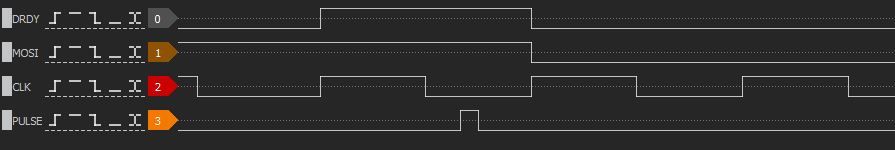

I found out that when I send my trigger over USB that introduces a delay somewhere that causes my EXTI interrupt handler to execute slower (too late). That causes the 1 bit shift. But If I sent every 500th (or 200th, 100th,... doesn't matter matter) measurement automatically there is no such delay.
And how it should be:
What could be the cause of this?

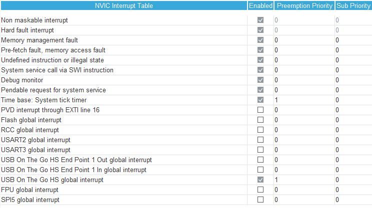

I did set my EXTI1 to highest priority from the program
  NVIC_SetPriority(EXTI1_IRQn, 0);
And this is how it looks like in cubeMX for other periphery:
I am also using TCM flash interface with ART accelerator and instruction prefetch enabled.
