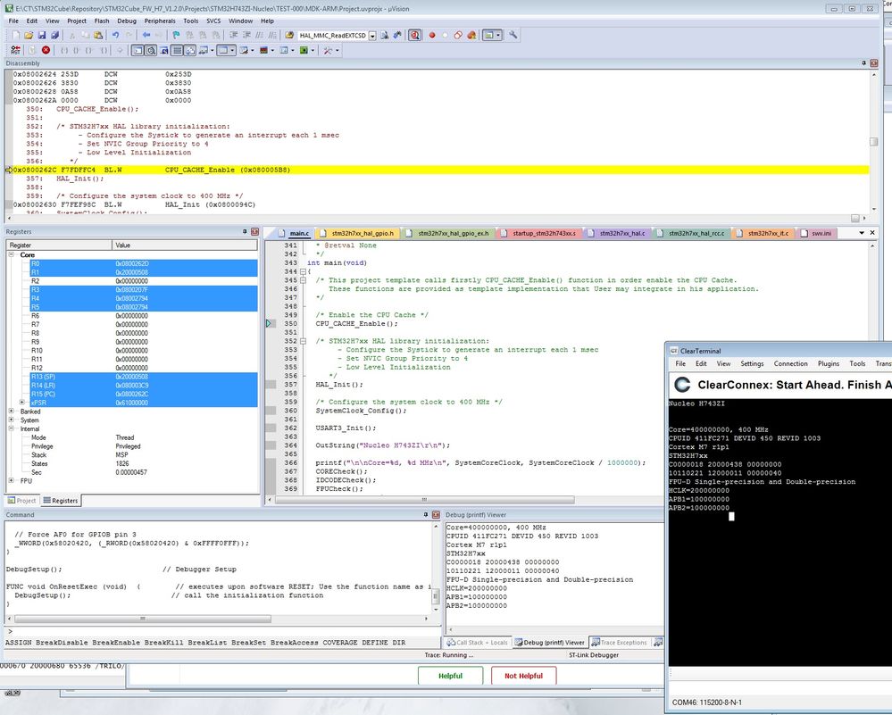

How do I use this UART, which UART number is it ? Is there an example showing how to use it (actually I tried all examples).
Thanks!
ran
‎2018-12-12 11:36 AM
The User Manual and Schematic indicate it is USART3 on PD8/PD9
‎2018-12-12 1:37 PM
Right, I wonder why there was no example using this USART3...
I shall try it. Thanks !
‎2018-12-13 7:07 AM
It does work with USART3, just what I needed ! Thanks a lot
