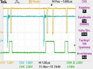

I am working on a custom board with the STM32F746IGT6. in witch is a FTDI Parallel-USB converter is connected to the FMC. My problem is that when I try to read data to ''fast'' from the FMC(after a while, and only sometimes) the FMC reads twice for one cycle. And the read function returns the result from the last transfer. This error is only sometimes and I didn't find any relationship with the content of the data. If I slow the velocity in them I pull data (> 2ms) then I have no more errors. The following image showsthesporadically
two reads at the same call. The yellow line is the read trigger. The blue line is the write trigger. Andthe green lineis an output pin that I trigger with software to recognizewhentheread function is called.

Is anything else connected to the FMC, do you use any other bank? Is this the only place where you read from that address range? Do you always read from the same address? Is the write into the same address/address range?
No, I have no idea what it is. JW- Mark as New
Yes, I have some shift registers to expand my IOs. But in other addresses. I have already comment away all other calls from the FMC to be sure that there is no collision, without success. I haven't looked yet if by reading the IOs it also does a double read sometimes. (I will try it later) In this case, a double read will not affect the inputs. The problem by the FTDI is that by each read pulls a character from the fifo. So that if the FMC makes a double read the first character get lost.> do you use any other bank?
No.> Is this the only place where you read from that address range?
Yes. Thats why I toggled the pin with the green signal. to verify that no other place calls this function.> Do you always read from the same address?
For the FTDI yes (0x68000000 + 8). I use other addresses for my IO expander. But as previously mentioned I turned all other calls off.> Is the write into the same address/address range?
Yes same as the read (0x68000000 + 8).I think the FMC is trying to make a refresh. or the Hardware detects (don't know how) an error by the first
read and try it again. Is there a configuration for such behave? thanks Robert- Mark as New

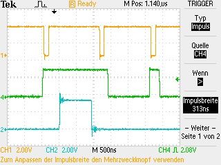

‎2015-11-12 3:07 AM
Once again: I don't have an idea what's going on.
Do you have interrupts enabled? Do those interrupts access FMC? Even if not, can you disable them all and observe whether this helps? Can you post disassembled portion of the code where the read happens? Can you produce a minimal example, only reading from FMC in a loop, and observe if this behaviour appears? JW- Mark as New
‎2015-11-12 8:10 AM
Hi Jan,
Thank you for your post. It helped me to locate the problem. In fact the problem is an interrupt intermediately or perhaps between the FMC access. It creates a second read from the same address after the interrupt is ended. To test this I used the following code running in the main function:
1.
SETPIN(H, 14); //green signal high
2.
tmp = (*(__IO uint8_t*) (NOR_MEMORY_ADRESS3)); //yellow signal.
3.
RESETPIN(H, 14); //green signal high
Then at the beginning of my interrupts I turned a second signal (Blue) on and at the end off.
I tested this with the USART_IRQ and the Systick_IRQ, with same result.
The following oscilloscope image shows the behavior:
SETPIN(H, 14);

So no indication what could run wrong besides an interrupt handle problem while reading in the FMC.
I suspect that this behavior is the same while writing. But I have not tested it yet.
My solution for now is to turn the interrupts off before the access and to turn them on again after that.

‎2015-11-12 8:55 AM
Robert,
