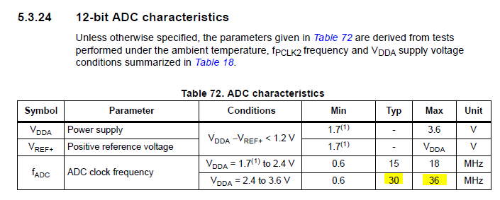

Hi @fbar​ , according with the STM32F767 datasheet maximum clock frequency of the ADC clock is 36Mhz:
The ADC speed is not directly related with the main core clock, this is the reason because the cubeMX always select to you 36Mhz :grinning_face: .

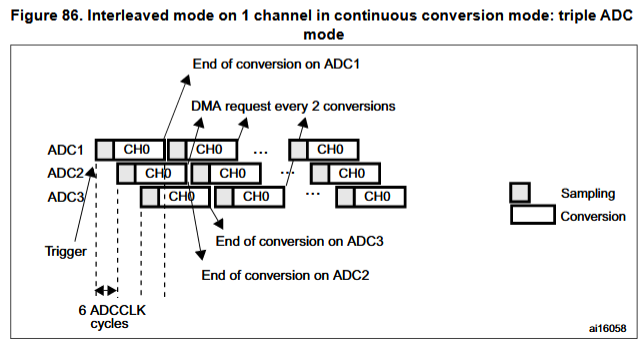

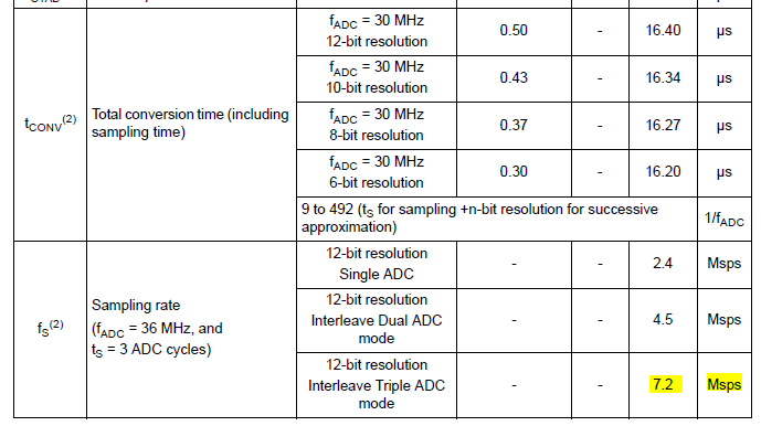

There is a way to speed up the rate of conversion and it's using the interleave mode, according with the datasheet those are the rates that you can reach:
About 7,2Msps, I tested it with the NucleoL476 and it really works (Even with only 2 ADC modules working, not 3). If the resolution its nor critical you could also speed up a quite more decreasing it (8 bits for example. This is the way that works the interleave mode:
Setting it in parallel with the DMA module works fine. There in the CubeMX files you can find a example project to set it.

First of all, there's no way to generate a 36MHz clock from any combination of prescalers and divisors if you select a 216MHz clock on a Nucleo board with 8MHz crystal (it might be possible with different crystals, haven't tried all combinations, but I doubt it). The only way to get a 36MHz ADC clock is to use a core clock of 144MHz. Try selecting the Nucleo F467 board in CubeMX and see if you can get a 36MHz ADC clock on the ADC. ADCLK uses PCLK2, and can use a 2 or 4 divider (higher, too, but not relevant here) , so since PCLK2 is 108MHz with a 216 core clock, you can only use a 4 divider, resulting in a 27MHz clock at best, decreasing the maximum sample rate to 1.8Msps from 2.4Msps per second. There's no /3 prescaler that can be used to get to 36MHz from 108MHz. not with the F4 or F7 clock tree (can be done with the H7, as pointed out)
Also, since, as I explained in my original question, I need to use all 3 ADCs at once (I'm actually sampling 6 channels, two per ADC, using triple regular scan mode), so can't use the triple interleaved mode. My actual ADC conversion rate is half the maximum possible, since each ADC channel must convert 2 separate samples. So from a theoretical 1.2Msps for all 6 channels (half the max 2.4Msps) I drop to 900K samples per second
