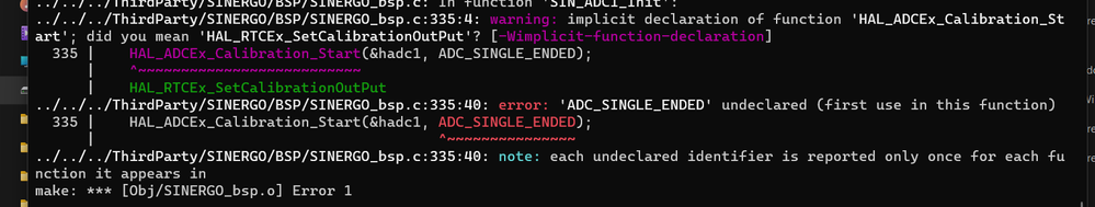

I'm trying to do a calibration of the ADC before starting it, but in comping i get this error.
I declared all the hal libraries related to the adc.
Thanks

..but obviously the HAL_ADCex....c /.h are not included.
did you generate project with CubeIDE /HAL and use an ADC in Cube ?
I included them, in the forum i read that there is no calibration function for F4 series devices?

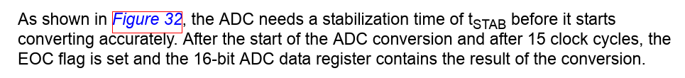

ok, seem so.
_legacyfs_online_stmicro_images_0693W00000bkaBeQAI.pngso here adc need no "calibration" after ADON + some us delay.
you could see also -> simply look at functions in the hal-lib...
here from F103:
_legacyfs_online_stmicro_images_0693W00000bkaDVQAY.pngand here F411:
_legacyfs_online_stmicro_images_0693W00000bkaEEQAY.png-- no calibration.
