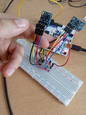

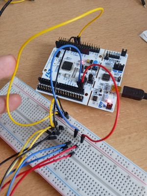

This is not a combo module, the two sensors are apart, i'm going to show pics of my montage so you can have a better idea : (colors mean the same as the colors in the diagram I sent)
Hope you can see everything fine.
I'm honestly even more confused now.. x)
So arguably circuit a lot more complex than diagrammed?
Link to module schematics?
VCC is what here?
Pull up resistors on every board?
Yep,
You can find the datasheet here for mpu 6050: https://pdf1.alldatasheet.fr/datasheet-pdf/view/517744/ETC1/MPU-6050.html
and here for HMC5883L : https://www.farnell.com/datasheets/1683374.pdf
VCC is yellow, corresponding to 5V.
"Pull up resistors on every board ?"
I don't have any, it might be the problem....
The thing is, it is said that mpu6050 and HMC5883L can work together without the need of pull up resistors.. ://
I'm going to get resistors tomorrow, and test this week, i'll keep you updated.
If you have any other ideas, feel free to share !
If you set I2C clock to low speed, maybe 20kHz, the internal pullups could be ok for a test:
set port/pins SCL/SDA with pullup on.
Ok, so now I do have better values, they are getting closer to the expected values for the magnetometer. I get for the MPU a sort of "flash" of data every 4 seconds with the correct values then it returns to incorrect values. But it's already much better, and it shows us that the problem must come from there !
