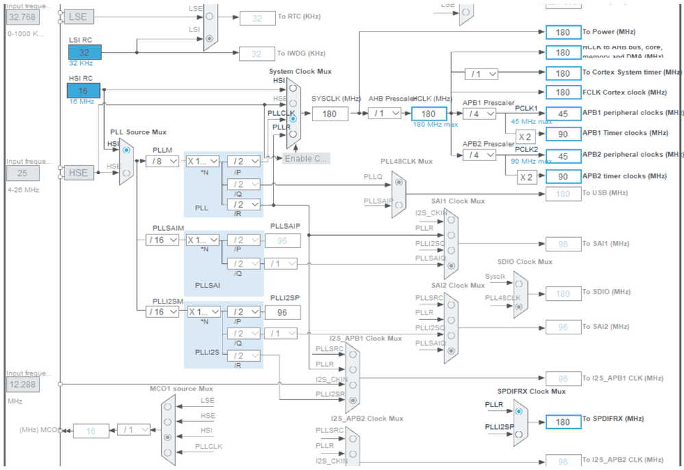

I'm trying to use a STM32F446 to receive some SPDIF-data. There are no complicated things to be done with the received data, just a few simple calculations. Unfortunately I do not receive anything at the moment.
I have configured the SPDIF-interface within STM32CubeMX: Selected input is IN0, the input does not wait for activity, the manximum number of retries was set to 63, and.the preamble bits are not copied. Everything else was left to default.
Clock configuration was done in a way where the core (SYSCLK) is at 180 Mhz, SPDIFRX also gets 180 MHz. Hope this is correct as I'm somewhat unsure about this part.

Where I'm still unsure: my clock settings. I just played around with them in STM32CubeMX until I got a core clock of 180 MHz (same clock for the SPDIF subsystem). Can a wrong clock configuration prevent the input from working properly?
