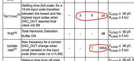

I would like to create a 1.5 MHz Sine Wave using TIMER + DAC + DMA.
In addition to clive's hints, you will definitely need to check the DAC output settling time specified in the datasheet.
I don't know the F42x part, but the DAC of other STM32 MCUs had times in the range of several microseconds, definitely not capable of >= 1MHz output.

You are not understanding what fm is telling you.
''In addition to clive's hints, you will definitely need to check the DAC output settling time specified in the datasheet.''
Look at the DATASHEET  (not the reference manual) :
In section ''DAC electrical characteristics''
In the table : look for ''tSETTLING'' and ''Update rate''
The 'update rate' tells you the maximum rate of change (small steps) the DAC is capable of (ie the max frequence it can generate)
The 'tSETTLING' tells you the time the DAC output needs to go to the final voltage if it does a large voltage jump. This can also limit the maximum frequency the DAC can generate.

Posted on March 20, 2014 at 12:25
Where can I find this information?
For the STM32F27x/F29x, it is page 160 ofthe datasheet (DM00071990.pdf):
I wouldn't expect better data for other F4xx parts...
