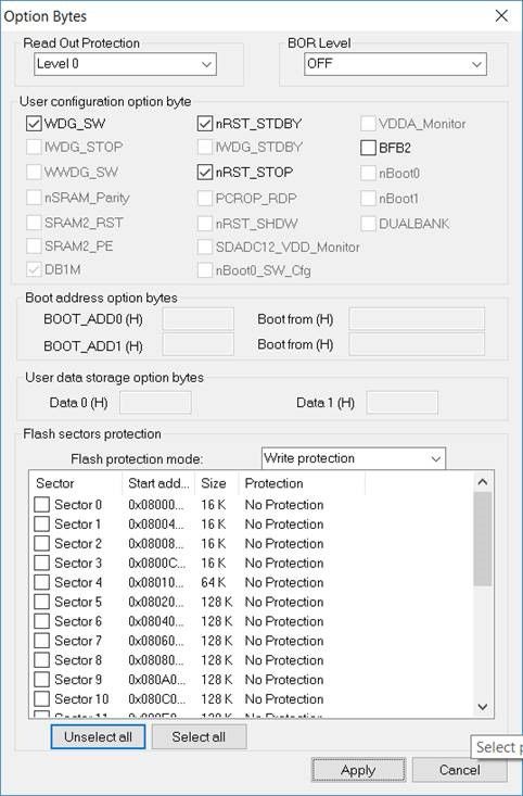

Hi all,
The following problem is appearing
changing
sectors write protection and
power disappearing in the middle of a HAL_FLASH_OB_Launch operation. After the next power up, flash options are reset with RDP = 1 and all sectors are read / write protected with SPRMOD enabled (PCROP protected sectors).
So the mcu is totally inoperative, the cpu is not able to load the interrupt vector through flash D-Bus
The starting situation is:

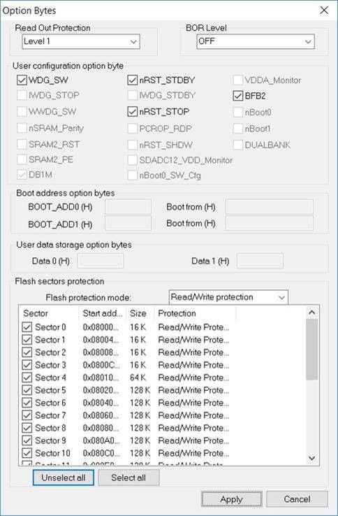

If power cycle the board repeatedly, chaining sector write protection operations, these are the flash options after some resets:
Anyone can confirm that this behavior is correct?
Is there any way to mitigate this problem?
