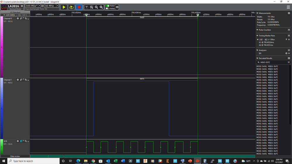

Posting for the first time here. We've been working with a 4d display that's based on an FT813 IC. The issue that we came to so far is the following.
  • 0x7C during Initialization is never detected although, it is detected from MISO. This is read on the logic analyzer. So my thinking is that the FT813 is awake and communicating to the Host.
Our setup for FT813 is default : Internal CLK, SPI is at 4Mhz, Pol 0 Pha 1 , STM32 Core Clock is 16Mhz.
As I debug the FT813memRead8 function it transmits the REG_ID (0x302000)address however during the SP Receive, we never receive 0x7C.
Only when we added an element to return &ftData8[2]; do we receive anything at all. Yet and still it never display's 0x7C that's on the host (MISO). Therefore, we stay stuck at
while (FT813memRead8(REG_ID) != 0x7C) //we should be reading chip ID from C0000 - C0003?
I have personally worked as a firmware engineer contractor for the DOD but, I have never been involved with starting any of the displays.
I tried contacting 4d and github but, porting to stm32 doesn't help our issue.
If anyone could provide a light to give me knowledge of our issue it would be greatly appreciated!
 We are transmitting and receiving but on other devices but, we we aren't we receiving 0x7C keeps us extremely baffled at this point and time.
Thanks in advance!

I found after reading " BRT-AN-006-FT81x-Simple-PIC-Example.pdf" it gave me an understanding of what I was doing wrong. Using someone else's code causes more trouble for me than it should.
So, to all, I thank you for your time!

Hi, Make sure that you are following the recommended Start up of the FT813. I’m thinking that you are so, After startup and a 300ms delay for self-diagnostics of the FT813, The problem that I had the most with the FT813 return of 0x7C was the following, 1. Bad SPI connection. Make sure that your MISO and MOSI lines are correct. Clock is without saying needs to validated too. 2. When validating your connections, it’s a very good idea to analyze your SPI Data. a. Validate MOSI --intended data to send to the FT813. b. Validate MISO -- intended data to sent from the FT813. c. Determine if there is a 0x7C on your MISO(without the MPU’s MISO Connected). Very Necessary! 3. Make sure that you have similar code when expecting 0x7C. This was an issue that I had for the longest time due to An issue I caused on my on. After realizing that I had the 0x7C on the analyzer but, not the MPU, I had to dig deeper into The understanding of the process. unsigned char FT813memRead8(unsigned long ftAddress) // Compose the command and address to read { HAL_GPIO_WritePin(GPIOD, FT813_CS_N_PD13, GPIO_PIN_RESET); //Transactions take place with CS_N low. #ifdef mine // unsigned long *Address = {0b001100000010000000000000}; unsigned long *Address = {0x302000}; uint8_t dummy = {0x00}; char *data = {0x00}; for (int j = 0;j<3;j++) { HAL_SPI_Transmit(&hspi1,&Address,2,100); // HAL_SPI_Transmit(&hspi1,&dummy,1,1); HAL_SPI_Receive(&hspi1,&data,1,10); HAL_Delay(5); } #endif unsigned char ftData8; // Place-holder for 8-bits being read unsigned char cTempAddr[3] = {0x00}; // FT813 Memory Address unsigned char *cZeroFill = ZERO; // Dummy byte3 //0x10/0x12(FT813/FT813 cTempAddr[2] = (char) (ftAddress >> 16) | MEM_READ; // Compose the command and address to send cTempAddr[1] = (char) (ftAddress >> 8); // middle byte cTempAddr[0] = (char) (ftAddress); // low byte for (int i = 2; i >= 0; i--) { HAL_SPI_Transmit(&hspi1, &cTempAddr[i], 1, 0); // Send Memory Read/Write plus high address byte //TIMEOUT MAYBE TOO SHORT!! BYTE TOO! } HAL_SPI_Transmit(&hspi1, &cZeroFill, 1, 0); // Send dummy byte HAL_Delay(20); HAL_SPI_Receive(&hspi1, &ftData8, 1, 100); HAL_Delay(20); // Set chip select high HAL_GPIO_WritePin(GPIOD, FT813_CS_N_PD13, GPIO_PIN_SET); // Return 8-bits return ftData8; I was able to randomly change the screen color, place dot’s etc.. but, it was slow in terms of updating the screen. Therefore, It led me to research for an easier way to allow my projects to progress. I moved to the STM32H747-Disco. I couldn’t find enough documentation that I needed for the FT813 in addition to the Lagging of the screen updates so, I stopped about 9 months ago. P.S I did not want to spend more time researching to get the screens made to run on the FT813 so, I switched an never looked back! Touch GFX much easier to get going and to use! I hope this helps and that you’ll have more success than I did! Regards, Hiram Hyman Chief Engineer HXE,LLC 563-5 Komekami Odawara Kanagawa Japan 250-0023 Phone: +81-70-4163-7552 Skype: design_1384 Email: design@hiram-xe.com Web: <> www.hiram-xe.com
