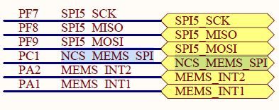

Today, I am trying to use SPI communication on my board. I saw that there is a gyroscope on my board. So, I thought it's a good idea to use this device as an example. Since it's already routed it up, I cannot mess up with connections, etc.

0693W00000D0z4pQAB.jpgThese are the pins according to the datasheet.

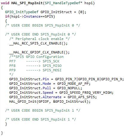

0693W00000D0z5EQAR.jpgThis is an SPI configuration made by Cube automatically. I didn't change anything from here.

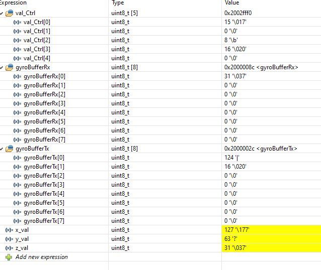

I checked and accidentally, I made PC1 as input. I change that value with GPIO_Output with default HIGH.

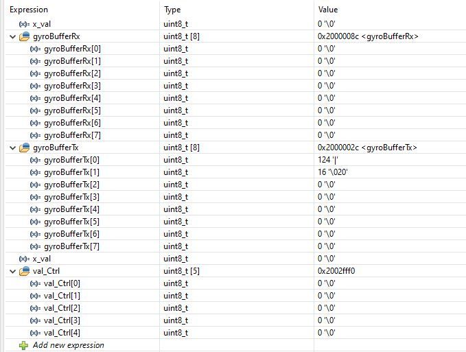

I put a control array to see if I could write anything on-chip. Sadly, the HAL_I2C_Receive function turns nothing (0).
SKAÅž.1
I realize that I cannot always send data through TX or RX, people make chip select high and low every time. So I change my initialize part like this

This seems wrong. How is gyroBufferTx defined? Probably want to pass gyroBufferTx and not *gyroBufferTx. It should be giving you a warning during compiling.

So yes, passing "*gyroBufferTx" will not work here and should be giving you an error during compiling. You need to pass "gyroBufferTx" which is the pointer to the buffer. *gyroBufferTx is the value of the first element.
0693W00000D10DxQAJ.jpgWONDERFUL!!
I cannot thanks enough, thanks to you (and all the community) my learning process got speed!
