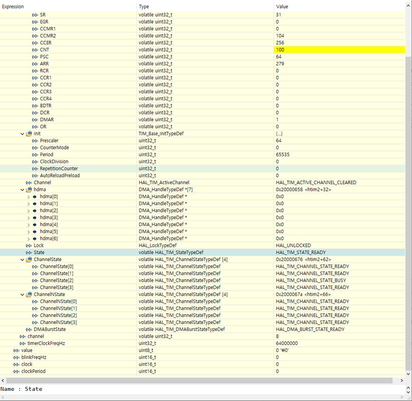

When I control the buzzer and the 1kHz signal individually,
there are no issues. However, when I try to control them simultaneously,
the buzzer does not sound.
How can I solve this issue?

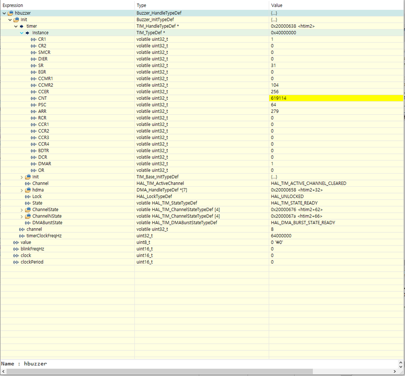

‎2024-04-23 7:47 AM
> However, when I try to control them simultaneously, the buzzer does not sound.
Read out and check/compare-to-working/post TIM registers content, for working/non-working setup.
‎2024-04-23 8:05 AM

this is main code
buzzer(BUZZER_START);
osDelay(500);
pwm_flag = true;
ctrl_pwm_1hz(pwm_flag);
When you first call the function, the buzzer and PWM operate normally,
But when you call the function the next time,
The buzzer does not operate normally and only the PWM operates normally.

It seems that the definition of htim2 in buzzer code is missing so try to add:
extern TIM_HandleTypeDef htim2;
into buzzer code.

I put the code into the buzzer, but it doesn't work.
#include "buzzer.h"
Buzzer_HandleTypeDef hbuzzer;
‎2024-05-08 7:15 PM - edited ‎2024-05-08 7:16 PM
We set a break point and analyzed the case closely.
When it's normal
TIM_HandleTypeDef
TIM_TypeDef *Instance; in
CNT; /*!< TIM counter register,
The value is within the normal range, but when there is no sound, there is a large value as shown below.
If we are trying to solve this, how should we solve it?
normal sound buzzer img = cnt range 100~ , 200~ , etc...
error sound buzzer img = cnt range 7237947, 619114 etc..
‎2024-05-09 6:06 AM
If you change TIMx_ARR in running timer (or stop timer for the TIMx_ARR change but don't clear TIMx_CNT) , use the ARR preload, i.e. set TIMx_CR1.ARPE.
