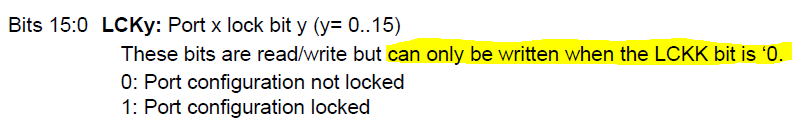

I'm using STM32F412VG microcontroller and I'm evaluating GPIO locking feature. Here is a code snippet with my test:

As you can see I've called GPIO_PinLockConfig function twice. It would mean that GPIOx_LCKR->LCKK Lock key bit for Port D is already active by first call at line 13. Because of the above and following entry in RM :
I've expected that second GPIO_PinLockConfig would not write LCK12 bit, because LCKK is already '1. However I can see in debugger that LCK12 was actually set. Could you please elaborate if I'm missing something or is RM inconsistent ? The Reference Manual, which I'm using is:
RM0402
