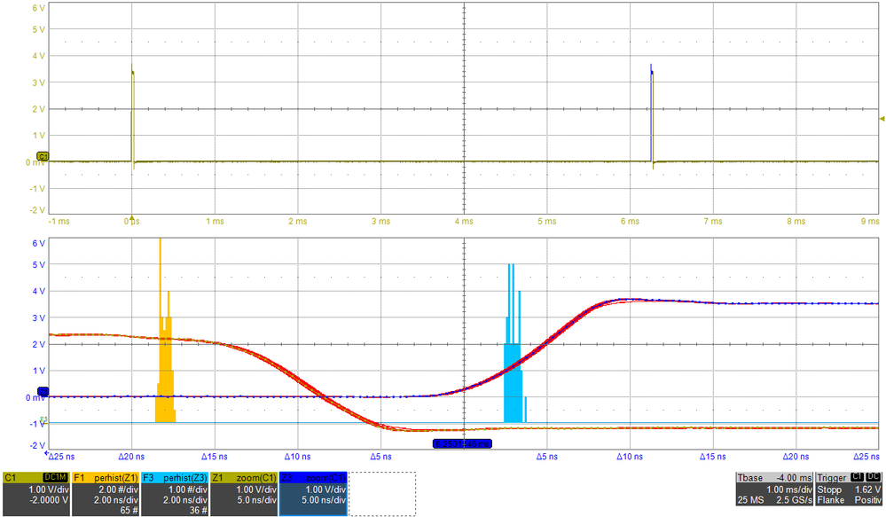

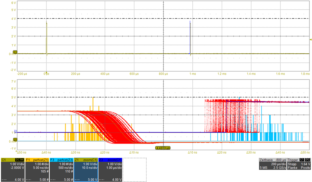

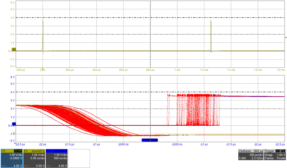

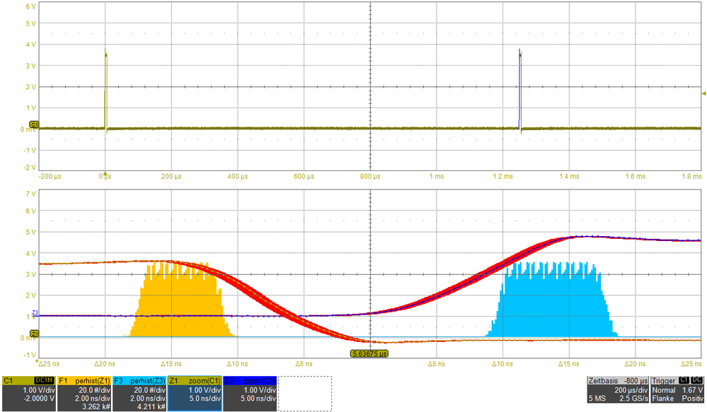

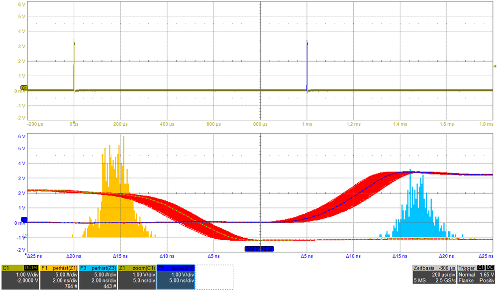

Hello @Sarra.S
sadly, i don't have your E-Mail, so i will attach the Files here.
I attached a 16MHz, 50% 3,3V squarwave signal to the PH0 Pin and the oszilloscope to PA3 on F410 and PA0 on L433.
Here is what i meassured: (On the top is the PWM signal, on the bottom zoomed in there is in yellow on the left the first falling edge of the upper signal and in blue the next rising edge, both with persitence on)
F410 with internal Clock and PLL: Falling edge (yellow) Jitter ~20ns, rising edge ~1,5µs Jitter
F410 with external Clock and PLL: Falling edge (yellow) Jitter ~3ns, rising edge ~3,5ns Jitter
F410 with external Clock without PLL: Falling edge (yellow) Jitter ~0,5ns, rising edge ~0,5ns Jitter
L433 with internal Clock and PLL: Falling edge (yellow) Jitter ~6ns, rising edge ~1µs Jitter
L433 with external Clock and PLL: Falling edge (yellow) Jitter ~1ns, rising edge ~1ns Jitter
Is it correct, that the internal clock is that unprecise?
Do i have an error somewere?
I hope, this helps.
Best regards,
Philipp
