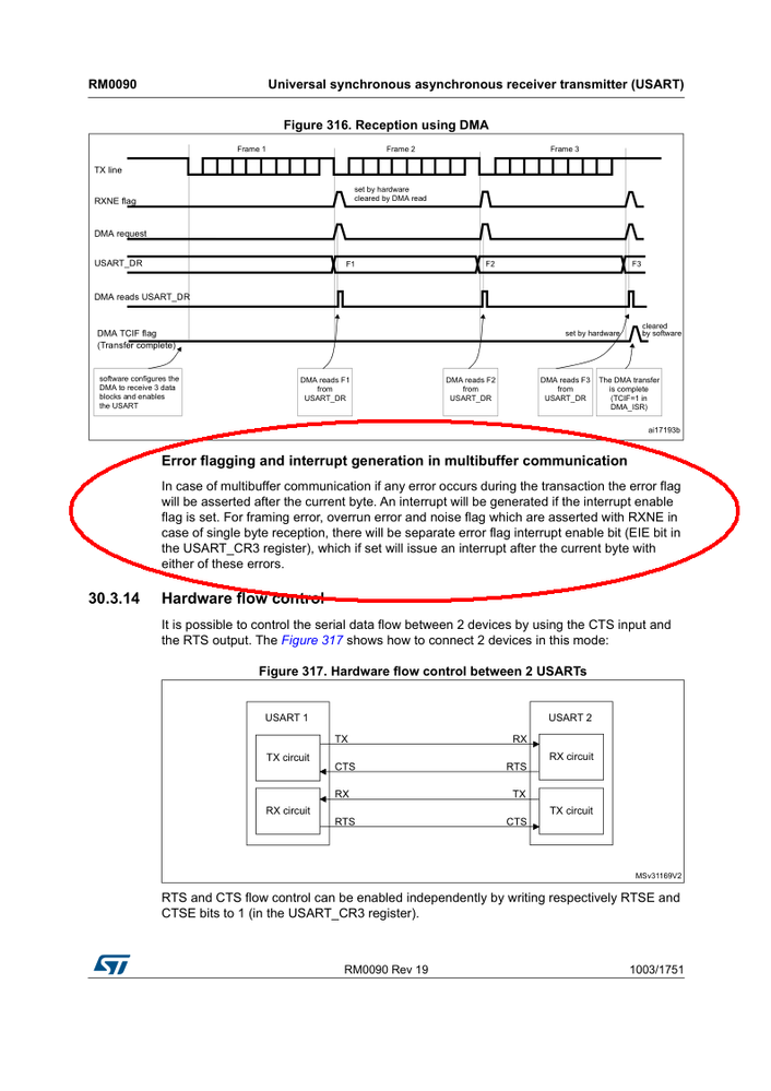

I need some clarification on using the Uart device in DMA mode
how should i handle the overrun condition (ORE bit set in SR register) ?
The read sequence SR and DR register reset the ORE bit
In DMA mode how I can do this ?
I must enable the EIE bit in CR3 register and do the reading sequence in the dma_rx_stream interrupt handler ?

Clearing ORE in DMA mode is the same as in non-DMA mode.
However, if ORE got set, it means your DMA did not handle the request. ORE is an error flag and should not be set during normal communication. You're missing data. I would look at why it's getting set and fix that.
Yes, but I don't understand your code, apparently you are using some unusual "library".
> Or the DMA transfer handles overrun clear the ORE bit and set the DMA transfer error bits in the appropriate LISR/HISR register ?
No. DMA is not aware of anything what happens in UART, except RXNE and TXE (in respective DMA Streams, if respective enable bits in UART are set and appropriate Channel in DMA Stream is selected).

Yes, but the reading sequence is to be  done in the USART interrupt handler, EIE is an USART interrupt, DMA does not know about USART features.

ORE can't generate itself an interrupt but is associtate to receive flag RXNE that generate Uart interrupt. Or rather the Uart interrupt must check the status of the error bits when receive a byte
The Uart RX interrupt (RXNE flag) will be generated also if configured in DMA mode ?
In the figure you posted there is a comment say the DMA clear the RXNE bit. And this is resonable DMA read the Uart DR register and the read access at Uart DR register reset the RXNE to zero

Sorry after write my reply I read one more time your previous reply and I think I understand
EIE flag !!! enable Uart interrupt where I can check the Uart error bits ...
Now is clear
