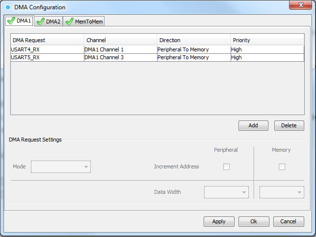

Implemented the same using STM32Cube.
I am working on the same task to forward data between two UARTs using DMA. In my case two devices are connected to central device via UARTs. Central device acts like a bridge between them.
In my case, DMA was enabled for UART4_RX with Peripheral to memory direction. Mode is set to Circular, priority high.
The same settings applies to UART5_RX DMA. See screenshot below.
UART4 and UART5 are configured as 115200bits/s, 8bit word length, no parity and one stop bit.
In source code I have added two lines of code:
HAL_UART_Receive_DMA(&huart4, (uint8_t *) &(USART5->TDR), 1);
HAL_UART_Receive_DMA(&huart5, (uint8_t *) &(USART4->TDR), 1);
This task appeared to be easier than I expected, so I am double checking if everything is set upped correctly.
Questions:
- DMA is configured to transfer one byte from ingress UART4 register to egress UART5 register.
UART4 is configured as 8bit word length + 1 stop bit. So I assumed that stop bit will be validated and then skipped by UART controller and exactly 8bits will be placed in UART4 RDR register. Afterwards RDR content will be placed directly to UART5 TDR.
Right?
- There will be no data loss as when any byte arrives to UART it will be immediately forward to another UART.
Is it possible that DMA will not be able to serve next request if previous DMA transfer is in progress?
‎2017-11-22 1:39 PM
If the receiving USART's baudrate is higher than the transmitting one, then DMA will simply shovel the incoming bytes onto the still working USART and they will get lost.
