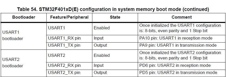

The device should support USART1 (PA9/PA10) and USART3 (check manual), the signalling must use EVEN PARITY, I'd suggest 9600 8E1 to start with. The signals are at CMOS levels, and are not compatible with RS232 levels without a converter. Use a terminal program like RealTerm which is capable of sending/receiving in HEX mode.Up vote any posts that you find helpful, it shows what's working..

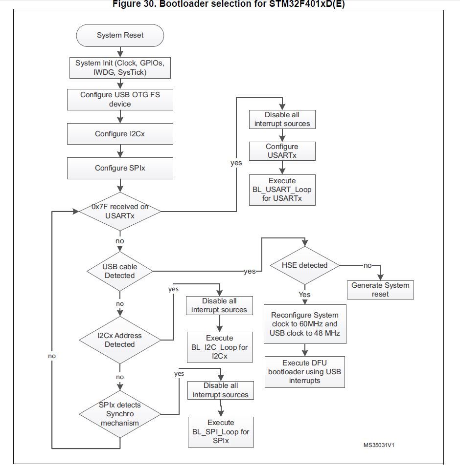

So I configured my RealTerm as below: baud : 9600 parity: EVEN Data bits: 8 Stop Bits: 1 But, the nucleo answers 0x00... According to the diagram(AN2606): 0x7F is first checked, then it detects if there is a USB cable. But the USB cable is always plugged to supply the board. I suppose that USB cable is detected before receiving 0x7F. As there is no External Oscillator on the Board, the system resets. That's why I have received 0x00. Is it right?- Mark as New

The USB connection on the Nucleo doesn't connect to the F401RE, rather just the ST-LINK's F103
The 0x7F should be sent with the ''Send Numbers'' optionYou'll need to diagram/describe what you've wired up. I have ST's manuals.Up vote any posts that you find helpful, it shows what's working..

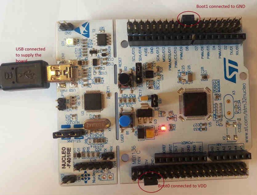

Attached a picture of my nucleo.- Mark as New
‎2015-08-27 5:40 AM
OK, but how is the USART1 (or USART3) connected? Going through the VCP to USART2 is not a valid path here.
‎2015-08-27 5:59 AM
Indeed, nothing is connected to USART 1. Why USART2 is not a valid path in this case?
According to the AN2606, the USART2 seems like it should be able to be used- Mark as New
‎2015-08-27 8:24 AM
Actually, I changed the USART. I switched to USART1. And It is working!
Thank you clive1.- Mark as New
‎2015-08-27 9:03 AM
Excellent.
The Nucleo VCP is connected to USART2 via PA2/PA3Up vote any posts that you find helpful, it shows what's working..
