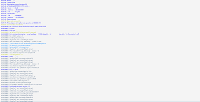

Sorry for my late feedback, to enter UART bootloader mood on the X-NUCLEO-WB05KN1 you have too:
  1. Connect the X-NUCLEO-WB05KN1 to a host board (NUCLEO-U575ZI-Q for example).
  2. Set the jumper JP1 to bootloader mood.
  3. Connect the CN5 RESET pin to a 3V3 source (external not the one from the shield).
  4. Connect the RX and TX pins of the CN7 to the TX and RX of your FTDI respectively.
  5. Connect using those options on the STM32CXubeProgrammer (V2.19.0):
  6. It should work fine:                                                                                                      STTwo32_7-1751296161658.png
    Best Regards.
