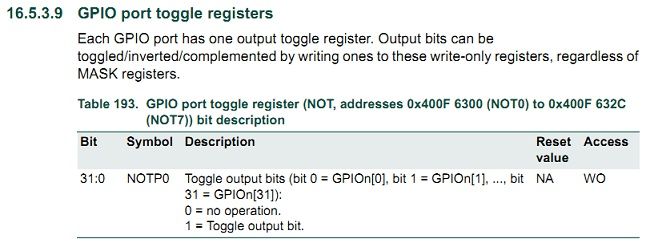

10. Atomic GPIO pin toggling by writing the BSRR register both set and reset bits to 1.
‎2012-01-10 12:10 PM
I think they won't do this (create toggle bit command), as this would get quite complicated for the processor to manage. This would be a Read-Modify-Make command, and together with these many bus structures, this gets very complicated - nearly impossible to implement this in a save atomic way.
Do you have an example, where you would really need such a toggle command very much, or is it just something ''nice to have'' for you?- Mark as New
‎2012-01-10 8:49 PM
Some NXP parts have this feature which I find quite useful.
‎2012-01-11 2:53 AM
It wouldn't be the processor to manage it but the GPIO peripheral...
The only change is to give the S/R bits of the BSRR register the same truth table of a JK flip-flop, you don't need more registers or ''commands'', it fits in the current GPIO architecture. Use case? everywhere you need to change the state of a pin *without* having to do a read/modify/write or having to make it into a critical zone because you need atomicity. Nothing transcendental, already seen on other platforms and the only feature missing in the GPIO. Giovanni- Mark as New
