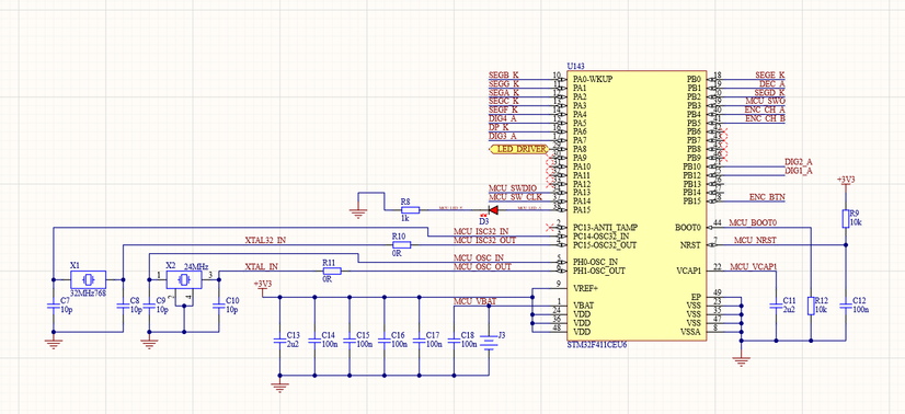

- STM32F411CE on custom circuit board (can provide schematics)
- 24 Mhz external crystal
- 32.768kHz external RTC crystal

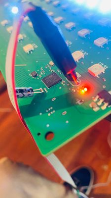

I have an oscilloscope if you would like me to probe something.

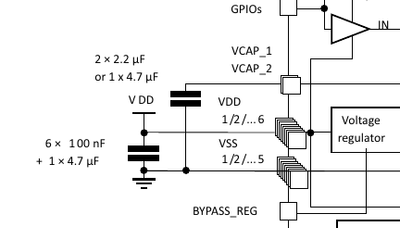

VCAP  should be 4,7u.

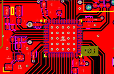

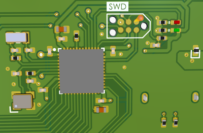

May  be I overlooked the GitHub files , can you please share the schematics and PCB , in particular power pins / VCAP and associated capacitors and crystal datasheet : 32KHz. I see the system clock is set to PLL using HSI and not HSE .

Yes I can. I am at work at the moment, but I will be home in a few hours and will share them.
I was able to get home early.
It won't let me upload .SchDoc files so I hope these screenshots will suffice:
I have one somewhere, let me find it and solder it on.

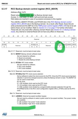

Another useful feature also to activate at startup before LSE is on the High drive mode to check , after reset it is set to low drive . To suspect any stability issue with your selected crystal and the 0 ohm resistor that is not necessary and I saw in other designs as source of issue .

I had said many times "I've fixed it this time" only for it to fail some minutes later. That being said, it is behaving as expected right now. I am going to keep it on with my debugger active and if the clock is still functioning a few hours later this might just be the answer
