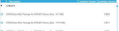

Currently on the official STM32F4 MCU package site there is a patch 1.28.1 to download which should include some fixes for ethernet issues (I hope those are fixes for issues I have) but this version is not availablie through Embedded Software Packages Manager (I did refreshed the list). I can download zip file from STM32CubeF4 - STM32Cube MCU Package for STM32F4 series (HAL, Low-Layer APIs and CMSIS, USB, TCP/IP, File system, RTOS, Graphic - and examples running on ST boards) - STMicroelectronics
but I can't import it using "From local..."
What's current status of 1.28.1 package?
I'm currently using 1.27.1 version, is there any reasonable way to update to newer package or do I have to generate a new project?

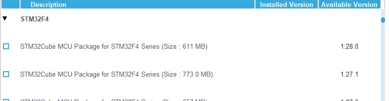

Does someone has any updates when the firmware version 1.28.1 will be available in STM32CubeIDE or STM32CubeMX via Package Manager? there is another way to install it via URL?
I just tried in latest version of both software and still don't see it there :(
‎2024-08-01 2:14 PM
You can download 1.28.1 fom github and install manually.

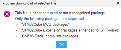

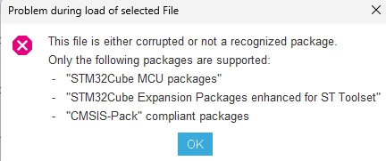

‎2024-08-10 7:11 AM - edited ‎2024-08-10 7:13 AM
It does not work :(
I tried to download the zip and add it from ST Package Manager by using "from local" option but it says the package is corrupted.
Any suggestions how to import it?

‎2024-08-10 11:59 AM - edited ‎2024-08-10 12:12 PM
Instructions how to install the code from the github are in the readme.md text, here:
https://github.com/STMicroelectronics/STM32CubeF4/tree/master
Scroll to the header:
How to use
and then : "to use the same firmware version as the one available on st.com, issue the command below after specifying the targeted vX.Y.Z version"...
The instructions assume that the user is familiar with git. Else, you won't be able to use this method and need to wait until the update is available in package manager.
Unfortunately using the zip of a release/tag is no longer possible because of lot of submodules. So, must use git.
‎2024-08-11 7:56 AM - edited ‎2024-08-11 8:17 AM
Newer versions of Cube MCU package can be limited to newer CubeIDE version. This may be on purpose due to incompat issues, or it may be just because of reduced attention to older versions. There is an XML file in the updater plugin directory (I can't remember the path off the top of my head) which shows the latest supported package version per family (for your CubeIDE installation). If (after a metadata update over net) the version shown there is below 1.28.1 (or whatever), you will not be able to upgrade to it through the updater, only manually - and at your own risk.
FWIW, I've done manual updates and had no issues, but I probably got lucky and my projects simply haven't overlapped with the incompat changes in that version. Logically, whenever there's an incompat change, they have to bump the CubeIDE version for the entire package, even if you need a specific different fix which isn't in itself incompat. You either have to upgrade your IDE, or roll the dice and apply the patch manually. I would expect a minor version to be compatible within the same CubeIDE version though, so I'm not sure what's going on (if you do actually have 1.28.0 installed, I mean).
One possible reason for this IDE/Package version compat requirement is that (IIRC) the templates used for code generation are not part of the Cube MCU package, but instead are part of the Cube IDE install. By that I mean the files are found under the CubeIDE install dir, not under the Repository dir where MCU packages are installed.
