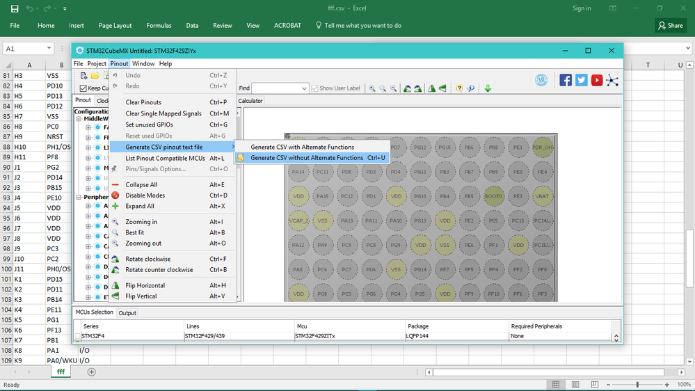

Does anyone know if there is an existing excel format version of pinout table, example: STM32F40xx pin and ball definition (Table 7 from STM32F4 series datasheet) available?

Hello !
Use CubeMx to produce the pinout table in csv format. (excell).
Regards
