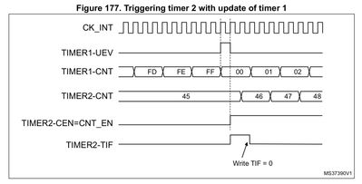

This should look like the following:
As in the picture, I am able to configure the timers as described and trigger the cascade once.
Then I read in the manual, that I need to "Write TIF = 0" and this is where I am stuck.
My understanding of "Write TIF = 0" is that I need to reset the status register:
TIMx->SR = ~TIM_FLAG_Trigger;
But that does not seem to be enough to "arm" the timers again.
I have tried resetting all interrupt bits in the SR registers and generating an update event with
TIMx->EGR = TIM_EGR_UG;
and many more variants but I was not able to retrigger the timers.
Any help on what I am missing to make the timer cascade retriggerable or what is meant "Write TIF = 0" is welcome.

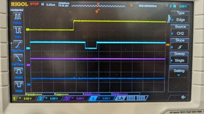

That is what I am trying to do. I can trigger Timer 2 via ETRF:
(yellow is my signal via ETRF and cyan is TIM2)
and I can also do this multiple times:

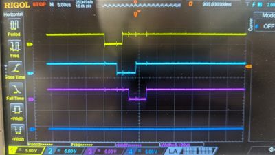

I am also able to trigger the cascade once:
(yellow: ETRF, cyan: TIM2, pink: TIM1, blue: TIM3)
But after I triggered the cascade once, I can not do this again, but instead the result looks like in figure 1 and 2.
