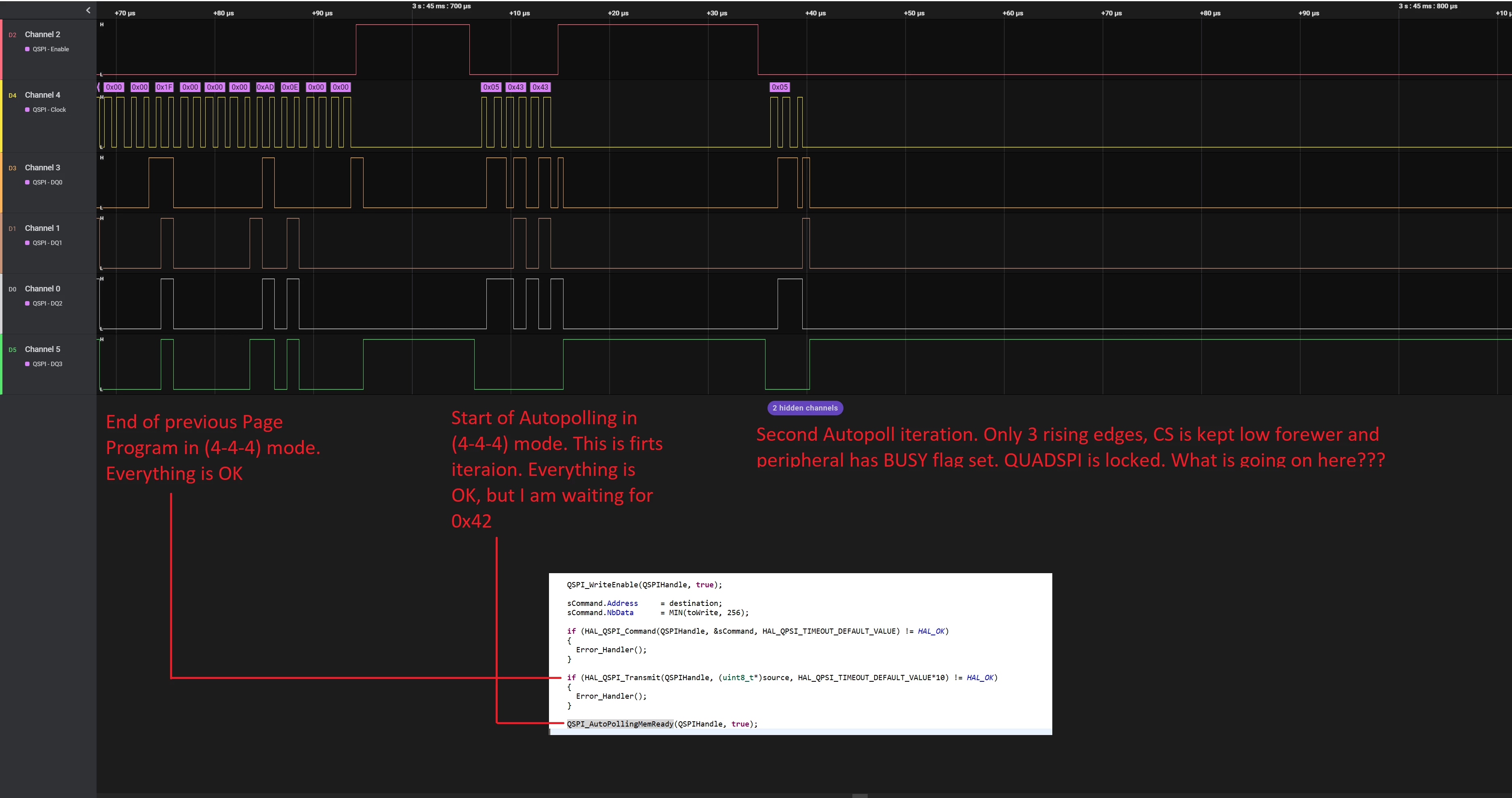

I am having an issue with autopolling too. I tried a lot of combinations of modes (1/4 Instruction lines, 1/4 Address lines, 1/4 Data lines). For me it seems there is a problem at least with (4-4-4) mode with autopolling. It looks it works fine in (1-1-1) mode or (1-4-4) mode. I connected it to analyzer and the results are quite strange.

I recall looking at the library source for the HAL QSPI, it has an odd exit path for the TIMEOUT, and you need to do an HAL_QSPI_Abort() type operation to terminate it at a bus level. None of the examples do anything to handle this properly in my opinion. This might change in time and with attention..
The exact implementation depends on STM32, QUADSPI or OCTOSPI, and library version, but the timeout is a software based one, whereas the hardware continues in this mode. You can check the instance status, but if still BUSY it's going to preclude further operation. You need to Abort the hardware operation to get back to an operational state. Similarly Abort can be use to exit memory mapped mode, rather than resetting and tearing every down which ST is apt to do in examples, and loaders, etc.

Thank you for response. Later yesterday I saw other @Community member​ posts and your reactions. I think that waiting for timeout and then calling abort will be in result slower than using (1-1-1) for polling (which is working fine)
