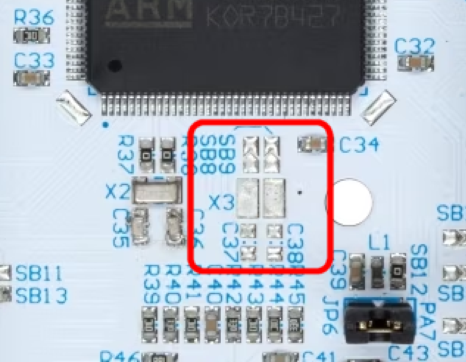

JFVNY is not mentioned in the document, it is the packaged font on the development board.
‎2024-04-17 8:20 AM
Yes, X3 is the HSE OSC.
Although I'm not entirely sure about the meaning of 'not provided,' I should be able to design with HSE 8MHz.

@Scarlet wrote:Yes, X3 is the HSE OSC.
No, it's not the oscillator; it's just the crystal - ie, the resonant element for the oscillator.
@Scarlet wrote:Although I'm not entirely sure about the meaning of 'not provided,
It means it isn't fitted to the board:
@Scarlet wrote:I should be able to design with HSE 8MHz.

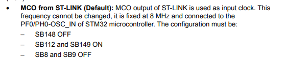

With X3 not fitted, you won't be using HSE at all - you'll be bypassing it, and using the 8MHz clock signal from the ST-Link.

The MCU doesn't require HSE at all.
HSE is just one of the many potential clock sources.
The default for the board is to bypass the HSE, and use the 8MHz clock signal provided by the ST-Link
‎2024-04-17 5:34 PM
My current understanding is that there is no X3 OSC on the development board, and the 8MHz is currently provided by the STLink. Right!?
‎2024-04-17 7:28 PM
Yes. By default X3 is not populated, for external clock source STLink MCO is an alternative.
‎2024-04-18 1:01 AM
@Scarlet wrote:My current understanding is that there is no X3 OSC on the development board, and the 8MHz is currently provided by the STLink. Right!?
Again, X3 is just a crystal - it's not an oscillator:
- The oscillator is within the STM32 - so that is always present;
- The crystal needs to be provided externally - it is not present on the NUCLEO-F429ZI board.
https://www.avrfreaks.net/s/topic/a5C3l000000UYYQEA4/t146620?comment=P-1401006
@Scarlet wrote:the 8MHz is currently provided by the STLink. Right!?
Yes.
