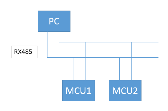

i'm trying to implement modbus function on mcu(stm32F4)
my structure as following
i receive data from usart6 by HAL_UART_Receive_DMA function(circular mode)
it's work when just only one MCU edge. but if two mcu edge (two modbus slave), it will make some problem.

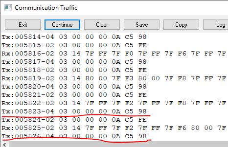

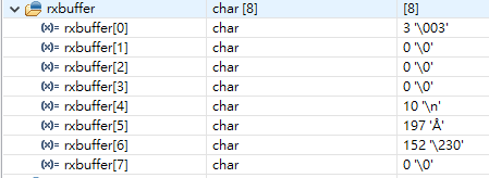

when i polling the mcu1 only, the rxbuffer from DMA is correctly(modbus-rtu query package)

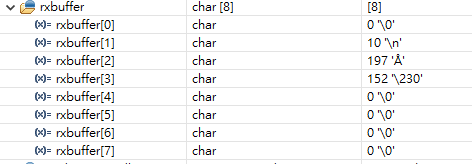

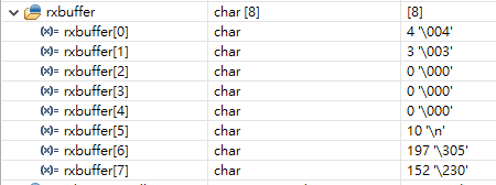

when i pooling mcu1(slaveID 2) and mcu2(slaveID 4), the package will be shift or incorrect.

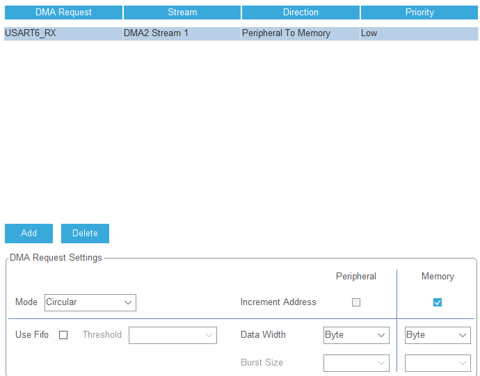

my DMA parameter

how to fix the rxbuffer shifting issue
