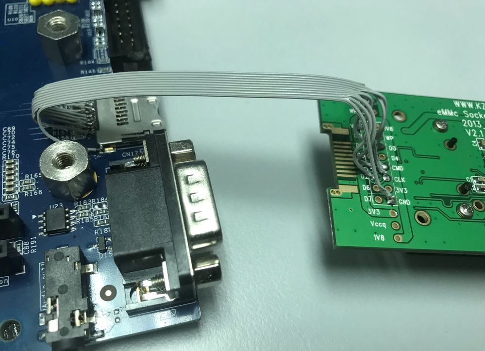

‎2018-06-13 9:50 AM
Hi
Turvey.Clive.002
‌,Actually I'm using STM32F779NI EVK and replace the SD Card interface bus by eMMC.
And this board using SDMMC1
Specifically HSE and debug USART
the HSE and debug USART also effect SDMMC1 pin. But the thing is I alr test with SD Card using SDMMC1 , it working fine.
And you say ST 's code is broken mean their HAL MMC has issues ? we need to do some modification to get it work ?

‎2018-06-13 2:27 PM
Ok, so this is a blind port to the STM32F779I-EVAL (or F769I-EVAL)
http://www.st.com/en/evaluation-tools/stm32f779i-eval.html
eMMC via SD1 (CN17)
User interaction is implemented via the VCP/RS232 USART1 at 115200 8N1

‎2018-06-13 10:09 PM
Hi
Turvey.Clive.002
‌,I tried to flash ur binary to the board, it doesn't work, nothing detected when power on the board.
And can i know how much effort to make the eMMC work ? Because we already asked ST support, they said it totally not support eMMC, we have to fix the mmc driverourselves. So we r going to change back to SD card.
‎2018-06-13 10:36 PM
Do you get any output via the serial port? You have the VCP and RS232 jumpers set properly? Other EVAL board you need to set the jumpers properly.
To use the ST-LINK VCP to connect you need to ensure the following are set:
JP21 2-3
JP26 2-3
I don't have either the STM32F779I-EVAL or the 769I-EVAL boards, perhaps someone at ST can furnish those? How do you normally output diagnostic information?
I have working eMMC drivers on F4, F7 and L4 platforms. I've got several man-days of effort, and several hundred dollars of parts invested.
