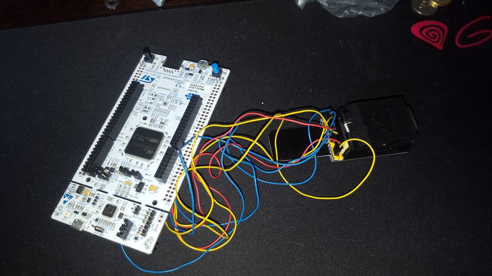

For my tests I have used
http://www.st.com/content/st_com/en/products/evaluation-tools/product-evaluation-tools/mcu-eval-tools/stm32-mcu-eval-tools/stm32-mcu-nucleo/nucleo-f412zg.html
  and
https://www.amazon.com/dp/B076HTDH2J
Like I described the initialization code seems to work. What does not is writing to the memory (returns errors) and reading I cannot tell, since I cannot write, but I assume it works. Also I am concerned about maximum of 2 GB capacity. Even thought you say that its just about instruction set, maybe the MMC 4.2 standard which STM32 uses is not compatible with higher capacities?
Also, as long I understand that libs are there if the hardware is there (on demo boards) its hard to believe that someone wrote this HAL without testing it. Or...?

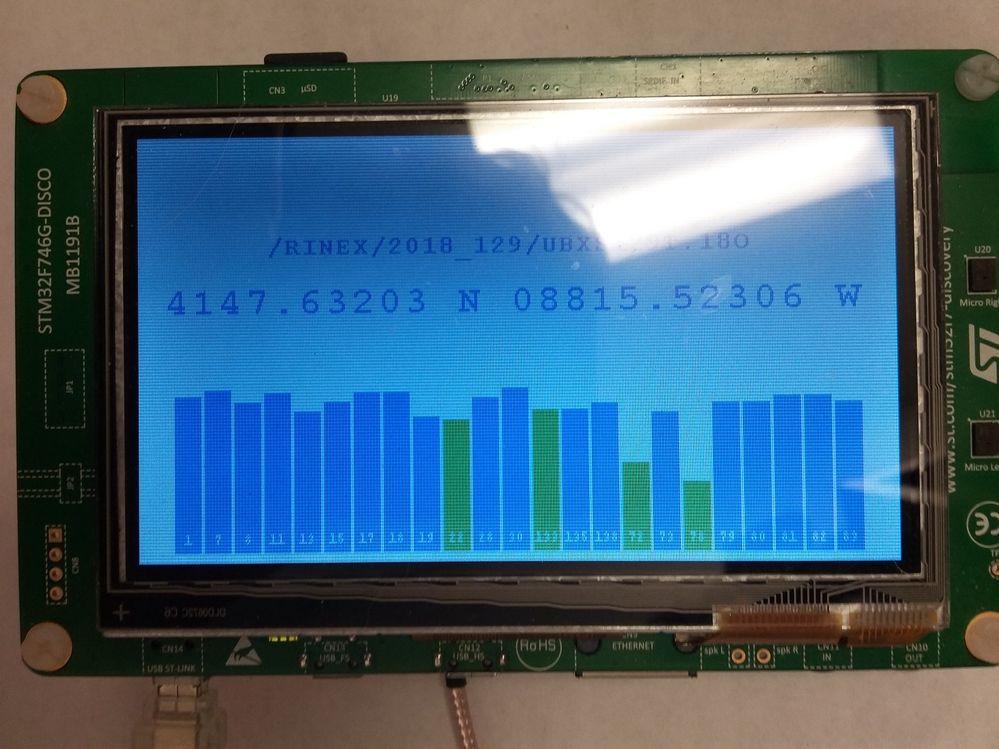

One of the pet projects is the CORS-LITE RINEX data logger, here running on STM32F746G-DISCO, where the expectation is the thing can run for hundreds of days without crashing, and a good way to stress code and hardware.
