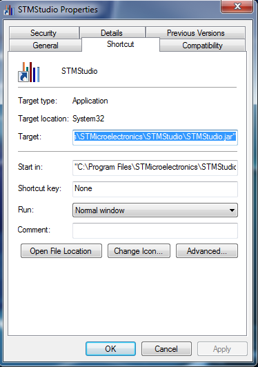

I may suggest: 1. To ensure that no other connection is established with the discovery before using the STMStudio (unplug/plug again the USB cable to be sure) 2. Ensure that the desktop shortcut is really pointing to the 32-bits version of Java machine (right-click on STMStudio desktop icon - properties - target should start by C:/windows/SysWOW64 on Win7-64) 3. If the issue persists, please post the file error.log that should reside into Program Files (x86)/STMicroelectronics/STMStudio/dll Best regards- Mark as New

I have installed win 7 x86, st-link driver, stmstudio and Java 7 jdk, but I still have the same problem. I run the program as administrator, and choose ST-Link SWD but I got a message ?Error opening ST-Link connection?

This is the target content: C:\Windows\System32\javaw.exe -Xms512m -Xmx512m -jar ''C:\Program Files\STMicroelectronics\STMStudio\STMStudio.jar''

Hi, I know it has been a few months since you have asked your question, but it might help others.
Even on Windows 7 x64 version, you can(and probably will have to for other reasons) install 32-bit, and 64-bit Java JRE(it doesn't matter if you have same version(e.g. 1.7.80) with different ''bitness''). For example, my target path inside shortcut tab, looks like this:''C:\Program Files (x86)\Java\jre1.8.0_51\bin\javaw.exe'' -Xms512m -jar ''C:\Program Files (x86)\STMicroelectronics\STMStudio\STMStudio.jar''
Path inside the first pair of quotes points to the installed Java VM(in this case 32-bit on Windows 7 x64), after that, follows the size of memory allocation pool which your instance will be using, and finally '-jar' with the path to your java package.
After you are certain that everything is OK on the ''software'' side, check your connections/wiring. I had the same problem previously, my root cause was a loose test clip :\ Perhaps, you could try to flash your device through the STMDiscovery's ST-Link, and immediately after that, try connecting through STMStudio.
