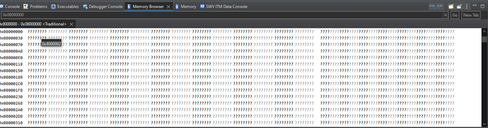

Why cannot properly see opcodes on memory browser ?
‎2024-06-08 12:58 PM - edited ‎2024-06-08 4:05 PM
I can see the addresses when I hover over them, but I can't see the opcodes. Is there a setting to fix this or is it broken?

Just to mention : memory can only be read, when debug stop core, at a breakpoint or click "suspend" .
While running, only last readed values or "????" shown.

I am using the STM32F407-DISC and trying to see the content of memory. I am a newbie so sorry for missing info.

Suggests this is a connectivity issue with the ST-LINK/V2 on the STM32F407-DISCO, make sure it has most current firmware. Check it is readable in STM32 Cube Programmer
The F4 doesn't have ECC (error correction / checking) so reading blank memory shouldn't fault, which could be the case for H7 parts, say. Those devices might reflect unreadable memory with '????' displays.

Thanks a lot. After your suggestion, I tried a different USB port on my computer. It works now.
Edit: It returned to the "????????" view. I tried all the USB ports of the computer.

Yes, I found out later that I was trying to read without clicking "suspend" (embarrassing :d). Thanks for the answers.
